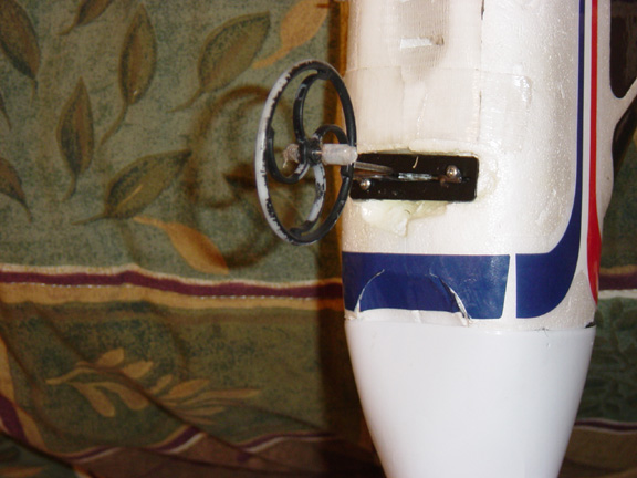

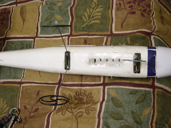

How did you make the nose gear? Have any pics?
Old 03-18-2004 | 02:24 PM
NMPhi767's Avatar
Joined: Jan 2004
Posts: 137
From: Phoenix, AZ
Default RE: GWS E-Starter
The kit comes with two black plastic brackets for the landing gear wires. With the tail dragger, only one is used. All I did to add nose gear was to install both brackets in the two slots that are in fron of and in back of the battery hatch. Both are there for the addition of floats. Then I bought some music wire of the same guage as the wire that the kit came with for the main landing gear. I bent it so it fit into the brackets just like the main gear but I modified a couple of the bends so it allowed me to have a single wire come down from the bracket.
I used a gws 51 mm wheel from a P-51 that I destroyed. I painted it black but some of that is rubbing off now.
