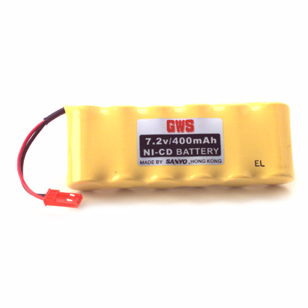

The stock pack for the GWS Slow Stick is shown below. It is a [link=http://www.horizonhobby.com/Shop/ByCategory/Product/Default.aspx?ProdID=GWSBP6N400]6-cell 400mAh NiCd[/link] pack which is rather outdated today.
Either a 6 or 7 cell pack will work fine. Many people use a 7-cell NiMH pack that provides double the flight time for a similar weight. Today's Lithium packs allow you to use a 2-cell pack that quadruples your flight time.
Any of these packs that weigh around 3-4oz will work fine.
