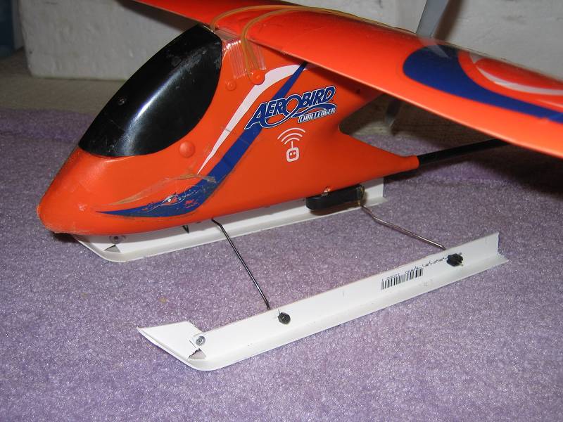

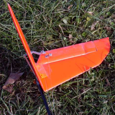

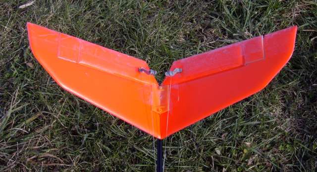

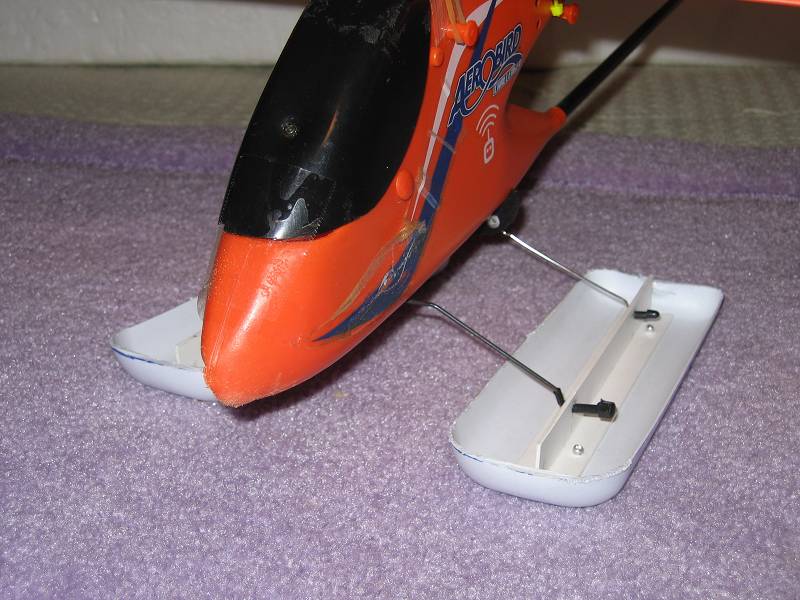

The two modifications that I made to the Aerobird Challenger is a Pro Tail and skiis for winter flying. The Pro-Tail is made by placing tape across the slot between the control surface and the stationary part of the tail, filling the slot with epoxy, then wrapping the tape over the top to keep the epoxy in place. Once the Epoxy is fully set, cut a new slot beginning at the old slot and going toward the front of the tail. The entire tip of the tail becomes part of the control surface. Adjust the location of the control lines through the control horns for differing amounts of response. I have mine set all the way in, and at full throttle on the stock batteries the plane is a handful to control. For details on maiking the skiis, go to my Skiis thread in the ParkFlyer section.

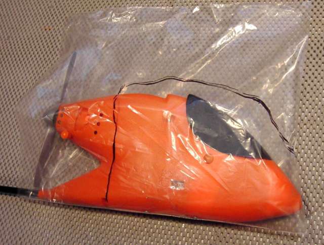

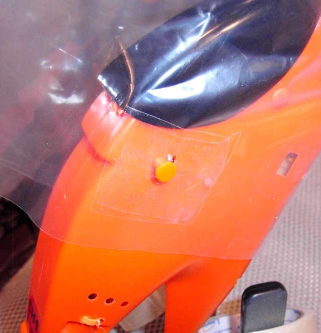

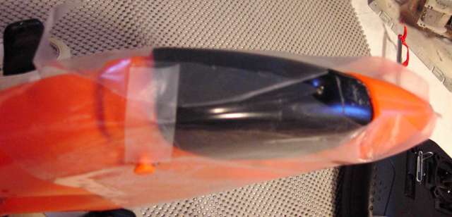

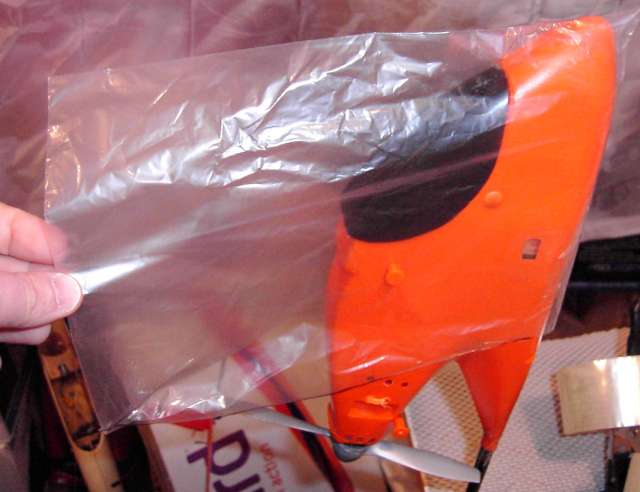

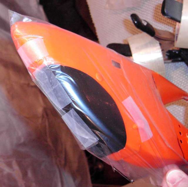

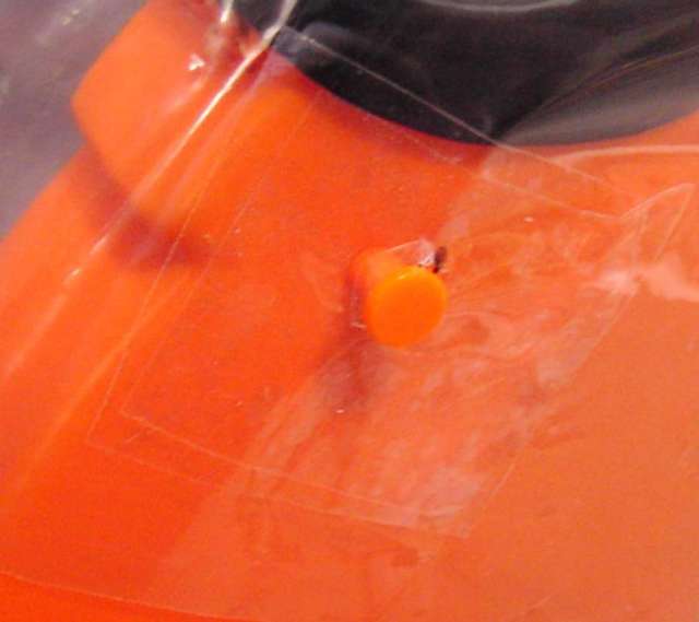

The last time I took the Aerobird out in wet snow, the insides got all wet and
the plane started glitching all over the place. The next day, after it had
dried out, there were no problems, but I didn't want to do that again.
Darn, no flying today.
I went out to the car to unload when I heard a little voice .... whisper ...
gotta fly!
Yes, gotta fly, but conditions are wet. No good.
Again I heard it and realized it was the Aerobird talking to me.
Ed, I just need a raincoat.
Raincoat? Right! Great idea!
So I grabbed the Aerobird and ran into the house to my workshop and made the
Aerobird a raincoat ... ... weather hood!
The posts at this link outline what I did.
http://www.rcgroups.com/forums/showt...19#post3442319
GOTTA FLY!

4) You can tape something very light but stiff to the control surface to
make
it longer. A piece of a business card works well. Tape it so that part of
the card extends rearward from the moveable surface. Try it with just a 1/4
inch and see the difference. You can use tape or glue or both. Make sure it
is flat and perfectly aligned with the control surface or it will throw off
your straight flight performance.
5) I taped across the move able part to the outer stationary part of the
tail.
Then you cut to the side of the moveable part of the tail and trim away the
excess tape. Leave the tape on the outer stationary part as it is weakened
by
having part of it cut away. This makes the control surface wider.
6) You can combine 3, 4 and 5.
7) Lastly, you can drill a new hole in the control horn closer to the
surface.
Again, this will give you more throw. However I would caution this one as I
believe it puts some real strain on the servos. I have heard of people
burning
out the servos this way.
So, do them one at a time.

After 300+ flights you can imagine that I have come across various things that
need to be fixed on my Aerobird. I fly it in the snow, the wind, the cold, I
fly it anytime and everywhere. My Aerobird is not babied.
On a couple of occasions I have gotten the interior quite wet. This lead to
some erratic motor control or problems with servo control. However when I let
it dry out, all was well. But not this time.
Two weekends in a row I flew it over snow. On landing, I got snow in the bird
which got all the electronics wet. Sure enough things didn't work right. So
I packed it up and took it home to dry out. But this time the problem did not
clear up. I was getting a pulsing of the motor above half throttle. What do
I do?
Since drying out did not help, I concluded that something had been left on the
circuit board that had been on the snow and it was causing a short. So I took
some electrical contact cleaner. In my case I used TechSpray RID-OX contact
protector/enhancer.
http://www.hmcelectronics.com/cgi-bi...duct/8591-0055
I sprayed the circuit board, still in the plane, especially the X port area.
Then I let it dry about 20 minutes. Problem gone.
About 2 months ago I had a similar problem with my transmitter. I was
occasionally getting full throttle even though I had the control all the way
to zero. I opened the radio and checked everything. Nothing obvious. So I
sprayed the throttle control with the Rid-0x. Let it dry overnight. Next
day, problem gone.
Net net, if you use your plane as freely as I do, you are going to get some
dirt someplace where you don't want it. If you see a problem like this, pick
up some contact cleaner, like Rid-Ox, and try cleaning the circuit board. If
your plane is not working right, it is worth a try.
Clear skis and safe flying!
This product was recommended by the local electronics store for this purpose.
Cleans and seals to protect from moisture and corrosion. He encouraged me to
use it freely.
On advice of a friend, I originally bought it to use on my ZAGI electronics.
Since we fly near the ocean, before I sealed in the electronics, he had me
fully assemble the receiver connections, then put it in a plastic bag. Then
spray the receiver and connection area of the receiver with this to reduce
chances of corrosion from salt air sneaking in.
A few months ago, I dropped that zagi in the ocean water about 2 feet from the
shore line where It was washed over by waves for a few minutes till I could
get to it.
I opened it up a flushed everything with water several times at the beach and
when I got home. I pulled everything out and let it air dry after one more
washing. After a week the micro 555 receiver range checked fine and after
inspecting al the interior components of the receiver I saw no signs of
corrosion. It was all fine EXCEPT the receiver battery and the plane locator,
both of which had to be replaced and neither of which had been sprayed.
EVERYTHING GOT A LIBERAL SHOT ON THE REASSEMBLY. So far so good.
I will keep my eyes open for any sign of problems and will post if I do see
any problems. However after about a year on the Zagi and three months on the
Aerobird transmitter all is working fine.
I will put the Aerobird at risk and fly it where I would not dare to fly
anything else because it will take so much abuse, put up with so much and, if
fatally damaged, $45 and I have a brand new fuselage and a full complement of
electronics, ready to live the free flying life again.
My HItec Micro 555 and Electron 6 receivers cost more than that.
Yes, my Aerobird is taken everywhere. That is its role in my fleet and it
fulfills that role well. Parkflyer, thermal glider, slope soarer.
