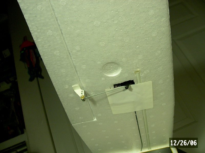

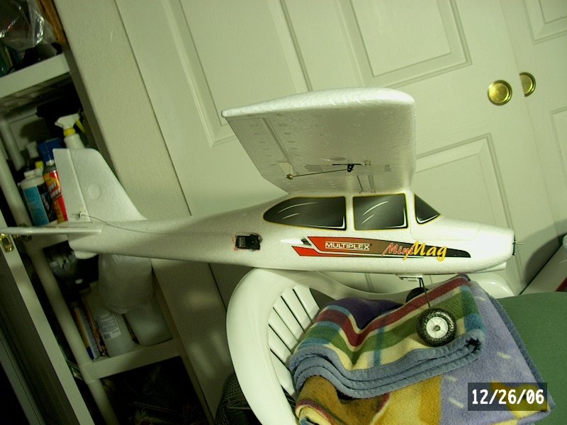

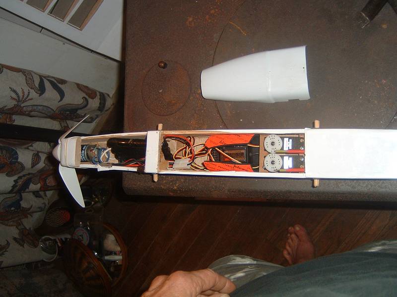

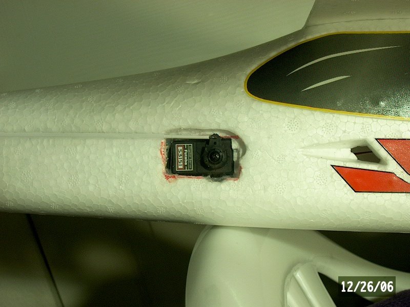

Got it figured out! Here is my hopefully soon to be flying MiniMag:
