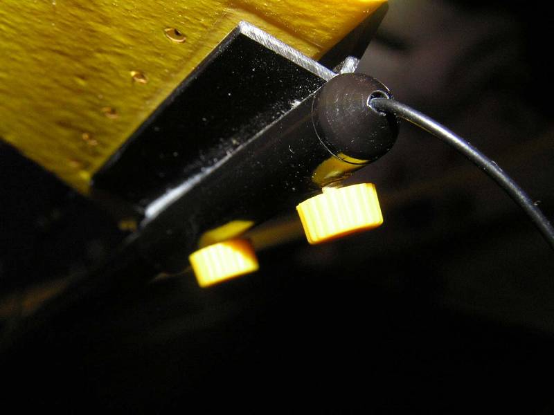

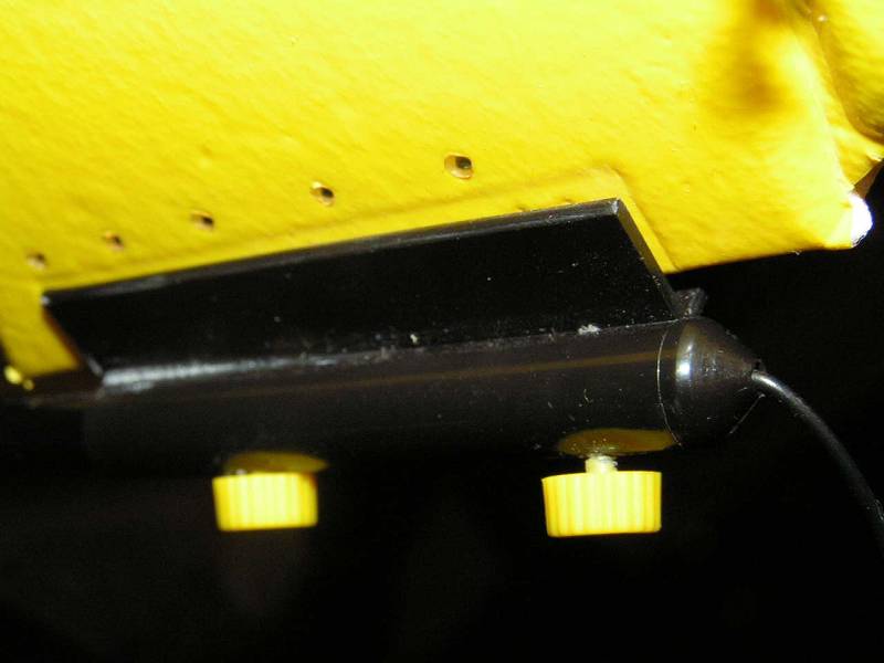

Hiya! You are right, the 2 screws at back need adjusting. Tighten the one at the front and loosen the one at the back - this slants the rear fins to give more elevator up force. Also you could adjust the metal srews holding the control horns. On the swift you do need alot of elevator up to get lift, more than on most planes (don't know why). Are you launching by hand or off the ground. The tips I've given are mainly for off the ground take-offs. There is a forum for Swift owners with lots of tips etc. Nice to meet someone here from Mexico - are you a newbie to rc flight and what other planes do you fly. Habla espanol mi amigo?

Hiya! Also make sure both wings are tight, if they're not put packing under wing root to lift the front of wing and make them tight fit. If you take wings out completely be careful, the wires that go into the fusiladge can pop back in and its a pain to fish for them. The sift sigt is under "electric planes" then "back yard park flyers" then "official swift thread". Lots of info on there. Have a good flight!!

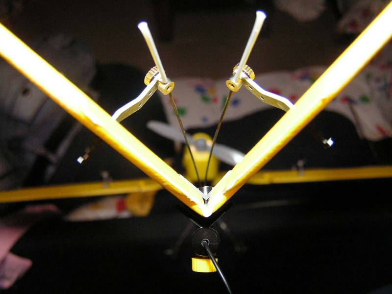

Greetings again. I mentioned the elevator up being needed. I proberbly took it for granted that our mexican colleague had set as per manual, elevator will probably need to be at max to get airborne off ground depending on wind conditions (as you mentioned - at neutral normally.). True there isn't a lot can be done for CoG but i use what you mentioned - battery far back. Packing under leading edge (if it can be done) can help maximise lift (some wings can be a slight loose fit anyway). Hope this clears up any confusion on my link. Thanks!!

On close examination of my Swift I don't see how adjusting the two yellow screws that secure the rear wheel and V-wing assembly to the shaft is a good idea. It appears the primary function of the two screws is to secure the rear wheel and the V-wing to the shaft. I loosened and tightened both but didn't observe any incremental tilt movement of the V-wing. It appears that you'd need to insert a spacer between the shaft and V-wing assembly to precisely adjust the rear wing tilt.

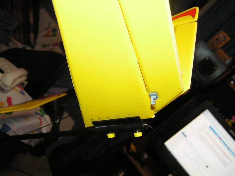

Hello.I followed the manual to the letter and adjusted screws as recommended but did not detect any difference in climb rate or attitude. I tried a smaller lighter battery from one of my other planes (only 600MaH) and there was a definite earlier lifting of swift - but flight time only 4 minutes! Have tried different props but stock is best - especially if you break them as often as I do. Tried other props off zagi and ME262 but they won't even move swift along floor! Good flights!

I repaired the two broken servo connector wires, strengthened the fuselage wing insert sockets, and designed it so that the wings are under some tension so as to stay in the sockets and not come apart so far or as easily in case of a crash. My Swift can function as a beautiful motorized glider with trainer ailerons that also has some aerobatic maneuvering ability. The winds are gusting today 15 to 20. Tomorrow's forecast favors testing out my zippy motorized "swift glider."

tam popo wrote, "The elevators were extended by adding broken elevators with tape to give twice the area."
He is not alone in what seems to be a problem with the Swift. From my experience hand launching the Challenger is a breeze compared to hand launching the Swift. I built-in some additional lift with that portion of the aileron(50%) that is now a permanent part of the main wing. I ran a strip of 2" celephane tape between the former aileron section and the main wing on both underside and topside with opposing force. It is fixed very, very tight/firm in place as if it were welded to the main wing. Yet it has some flex if enough force is applied, but returns to its intended position. This new section is fixed slightly upward for some additional lauching lift. I made sure that each newly attached wing section has the same degree of upward lift on both the left and right side.
Now I won't need to tinker around with the V-tail screws, V-tail shim spacers, or increasing the surface area of the elevator/rudder. Now I can always trim the ailerons and elevator/rudder as should be once the proper lift angle is determined for the newly fixed wing section that was formerly 50% of the aileron.
