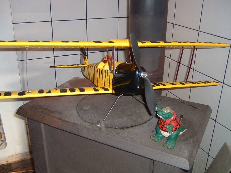

A few options:
Multiplex Mini-Mag - High wing 4 channel trainer - easy to fly but with a decent motor can also teach you some aerobatics.
GWS Estarter - Cheap, 4 channel, easy to fly, durable.
GWS Tigermoth 400 - Beautiful scale bi plane, easy to fly, easy to repair, but not as durable as the estarter. Can do some mild acrobatics with provocation.
Stevens Aero RV4 - Kit build balsa - a beautiful flyer and flys well on cheap brushless setup. Doesn't tolerate bad landings. Kind of expensive.
I wouldn't worry about the vtail on the swift - from your perpsective it's just like a normal elevator it just means it doesn't mean a vertical and horiztonal stabiliser. Only drawback on the swift is the lack of rudder - the vtail is setup to do elevator stuff only.
There's a few thoughts for you.

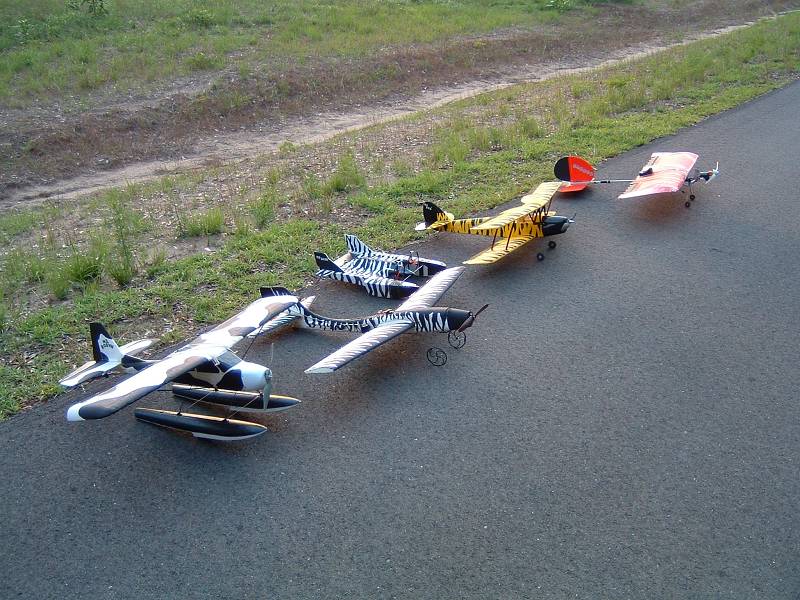

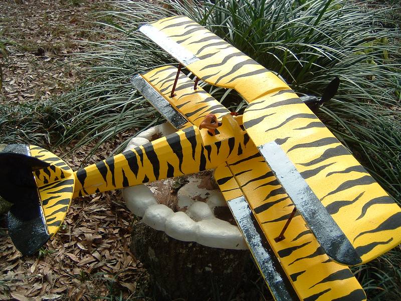

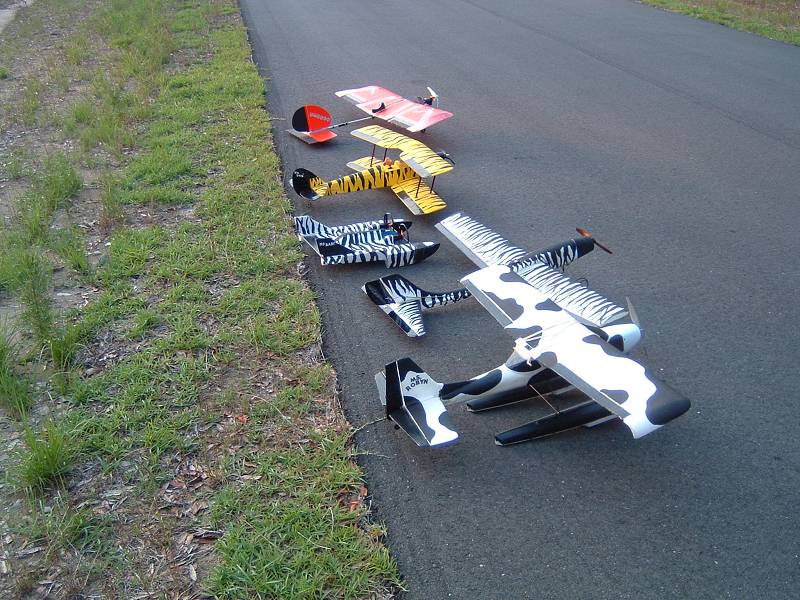

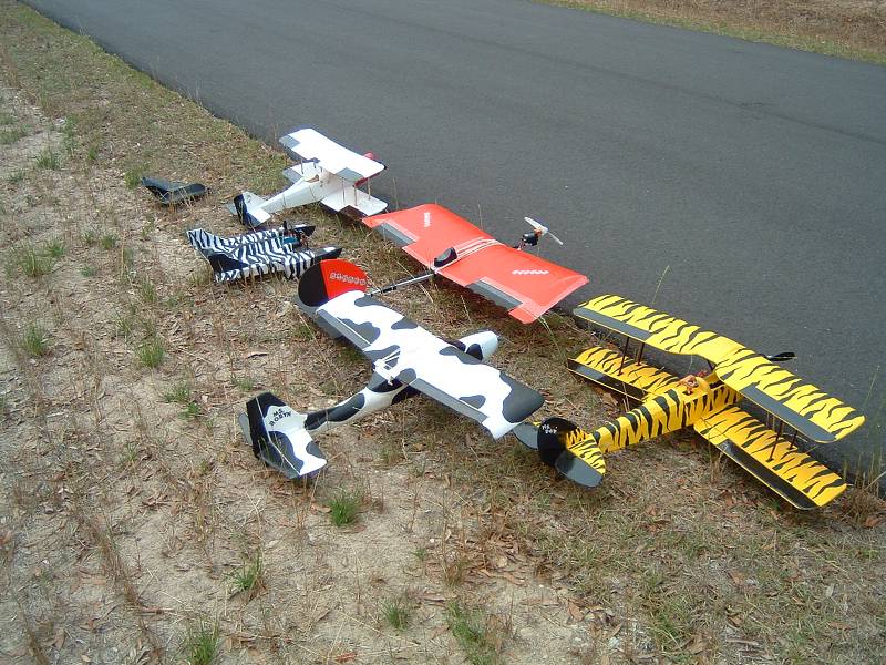

Mcalex9 It would seem you have some experience on the sticks and if the super cub is getting boring then the GWS Formosa might interest you, it is a low wing plane that can fly fast and yet slow down and float in very nice. I had one for a long time and very much enjoyed it, it can be good for learning aerobatics after you get used to the ailerons, that is the only down side to the mini mag or e starter they are limited in what they can do because of the high wing and having more dehedrial than the formosa. I have a E-Starter now and consider it my most reliable but predictable plane, I fly it all the time but for a nice easy relaxing flight not all out adrenilin flying
Just a thought, good luck with what ever you choose

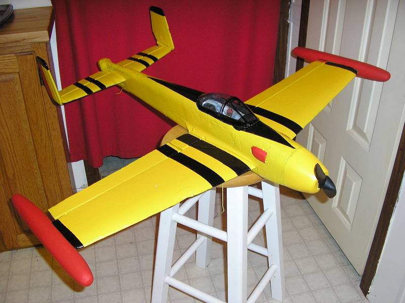

Neville stay tuned for more about the formosa, I have a few freinds that have and fly them and I WILL be getting another one as I realy liked mine A LOT
I have a funny vid and the final flight I'll post later just for fun. Gotta go for now but stay tuned
OK I'll try to keep this short, the plane I had was given to me by a freind, it was a little busted up when I got it, I glued it all together and put the stock geared 350 motor in it, it flew very good but lacked real power, (you know as I think back this plane was a first for a lot of things)
anywho I flew it like that for a few months and one day my freind and I installed a brushless motor in it, this was my first experience with a BL motor, on the fisrt flight the power was so balistic to me I lost control and promply crashed it again
,,, well I put it back together and began a little easier with the power and got used to it, then I found I could learn all sorts of things like flying inverted, inside and outside loops, realy nice almost axial rolls, just short of unlimited vertical flights, and the best part was I went from 5 min flights to up to 30 min on 1 batt. My set up was a BP-21 with a 7X4 prop and a 3S 1350 ma lipo and that is what stayed on it till it's final flight that dreaded morning [
] My AUW was around 25 oz and would have been more like 18 to 20 if not for all the glue/packing tape and paint I had added over it's life.
