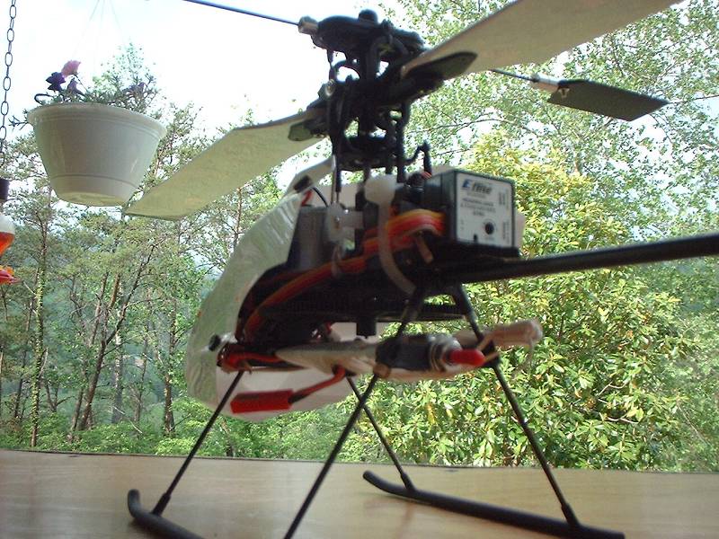

I used a 10 amp toggle switch on my Heli
to do exactly that. It has a Red cover on the
toggle. Hope it helps /
Bob
