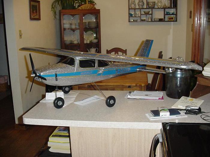

It's Chrome!!!
And for the last time I'm not a girl, dang it. GG is an airplane. www.thelostsquadron.com
Join Date: Oct 2007
Location: somewhere,
SC
Posts: 125
RE: Now how do I get this thing in the air?!!!
LOL. Sorry, it just looks glittery in the pick. Get's my wheels turning. [sm=idea.gif] The chrome looks cool too.
I'm guilty of thinking you were a girl as well. Oops![X(]
