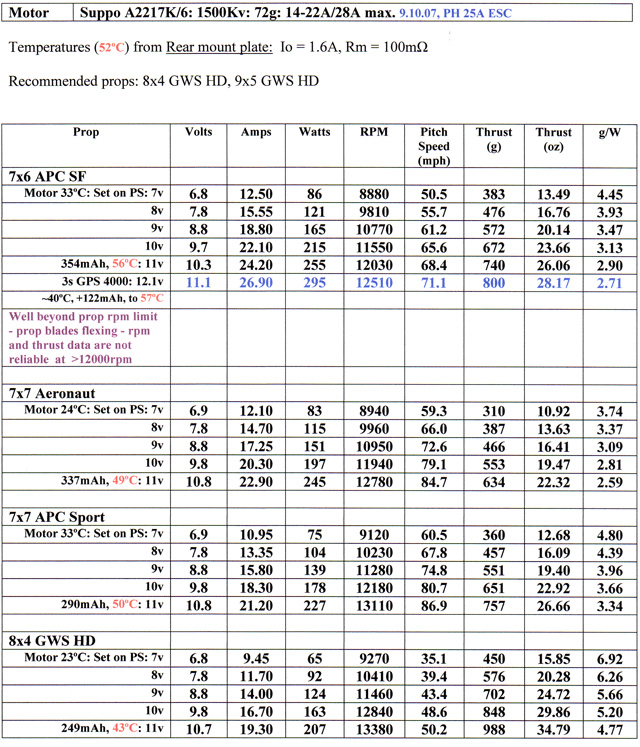

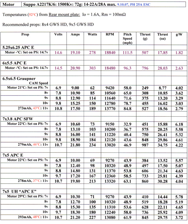

Put 200W through a 7" prop and that should do you: try a Suppo 2217K-6 motor from www.lightflightrc.com
ID:	1052640   Click image for larger version
