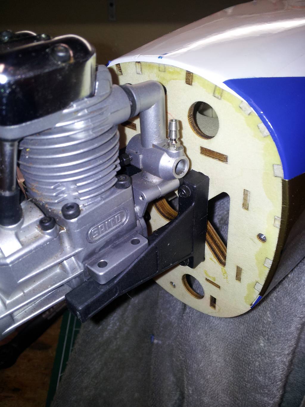

I picked up the Rhapsody ARF today. The firewall looks pretty strong as does the fuselage where it connects to the firewall. The Saito will push the prop further forward than the electric motor so I will move the cowl further forward also.
The picture shows the Saito 40 and the fuselage getting to know each other!

The shows the engine mount mounted using the existing blind nuts that would normally be used to mount the Power 25 - I realize I need to cover the firewall with ply but I am thinking of using the existing blind nuts. Currently they move in and out in a X that allows different motors (Power 25 or Power 32) to be mounted. It just so happens that the SIG engine mount that I have has holes that line up in such a way that the Saito is positioned just about right.

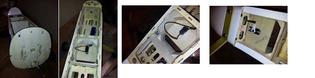

These pictures show the progress so far.
I removed the back of the existing firewall to get the nuts that were inside the firewall - they were not quite in the right spot to line up with my motor mount. I then put ply on the front and back of the firewall and used 3mm blind nuts.
Used 3/32nd ply to a front firewall and back firewall plus two formers and two doublers and the throttle servo tray. Used 3/32nd because I had a big sheet of it!
The intention of the formers and the doublers is to make the middle part of the plane a lot stiffer. I figure that with a heavier engine (11oz versus 7oz) and the receiver battery towards the back then there is more stress in the middle. A bad landing could cause cracks.
Cut the 3/32nd with xacto knife to minimize the amount of sanding and to get very tight fit.
The throttle servo is a Hitec HS65 mounted upside down - had to be careful with the placement to clear the lower wing center section which is why I used this type of connector to the servo arm. Used 15 minute epoxy on the fireway and CA elsewhere. Used thinned epoxy to fuel proof the firewall.
Had to cut the engine mount slightly and allow the engine throttle arm go into the firewall to allow the engine to be positioned as far back as possible - it is still close to an inch further forward than the Power 25 would be. This will cause me to have to mount the cowl with spacers and to put the battery way back to get the CG in the right spot. So far so good.

This photo shows the 4oz Hayes tank installed. Also the blocks for mounting the cowl which mounts almost 3/4 inch forward of stock because the Saito sticks out further forward. I made the blocks from two pieces of 3/8 bass wood glued together and then drilled and tapped (the wood) for a 6-32 screw. Then used a piece of 3/4 inch triangle stock to make them stronger. You can also see the cowl which has been cut to let the Saito stick out. Cutting the cowl means you have 3 mounting tabs rather than four - so I used 5 minute epoxy mixed with micro balloons to strengthen the bond between each tab and the cowl. So far so good.
