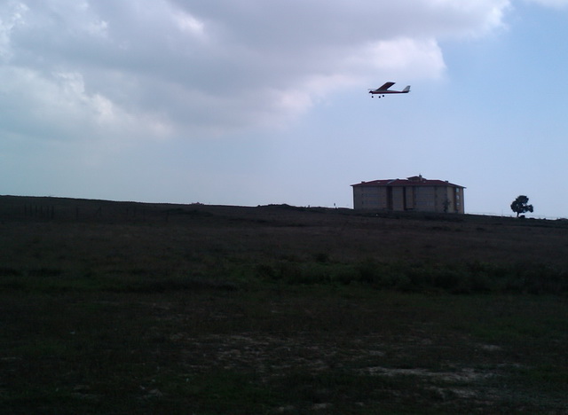

Default RE: Pt Electric - Glow Conversion Question
my plane flying well with OS .15 max.
