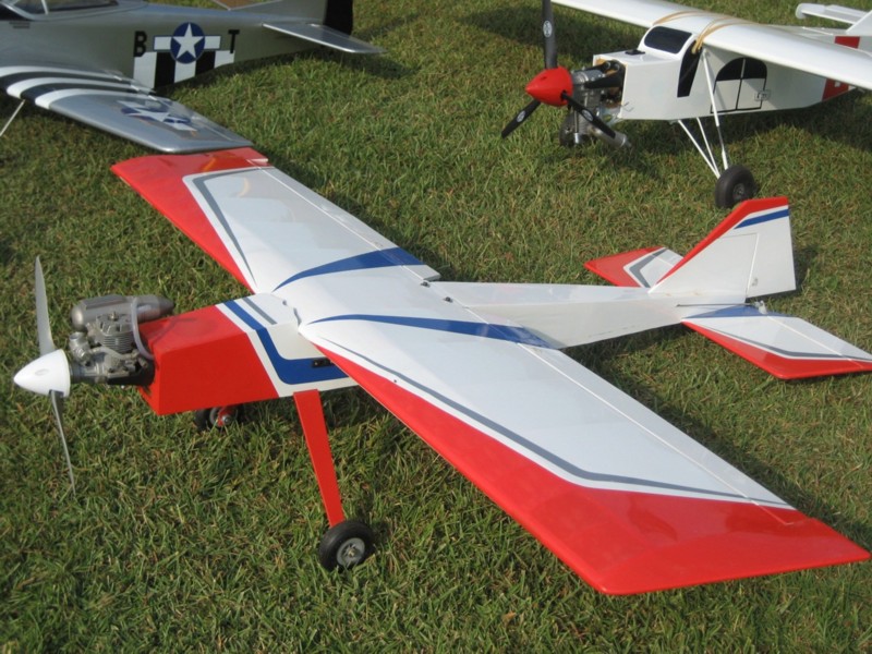

I converted a E Flite 25 Stick with OS 32. This is a very fun plane. Very fast and a fast vertical. It is a little nose heavy.
Old 02-01-2010 | 10:02 PM
  #27
Joined: May 2006
Posts: 117
From: Taylors, SC
Default RE: Electric to Glow Conversions
E Flite 25 stick coverted to glow with OS 32.

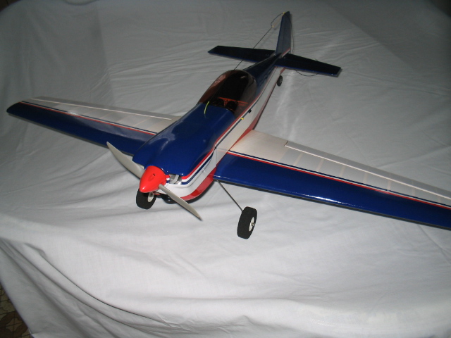

Here's my conversion, Stephens Aero Cap 232 with a Norvel .06. The fully cowled and inverted engine overheated, so a LiteMachines heat sink head was used to cure the problem.
