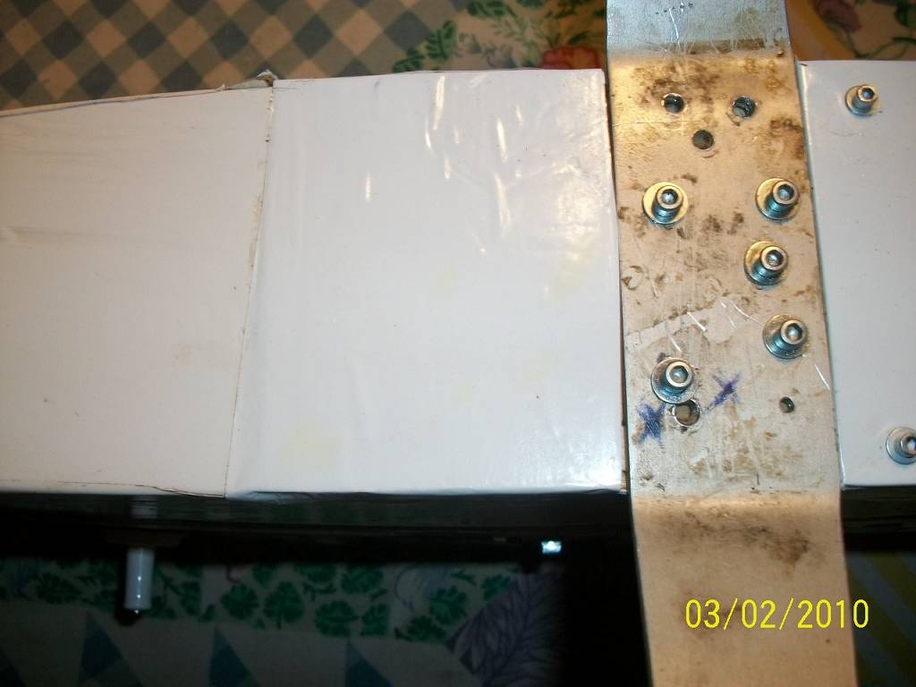

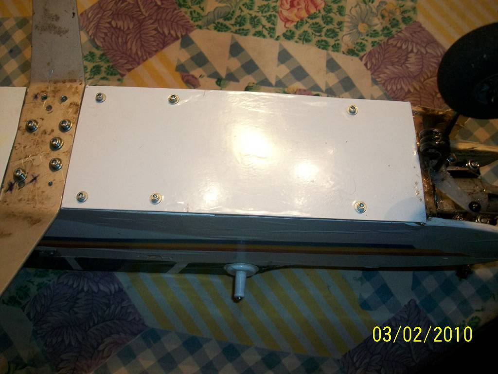

Hello I have already converted mine. Mounted OS25, has pleanty of power. I left micro servos in,
they work fine. Beefed up fire wall,fuel proofed,w/clear dope. Cut acc. just behind fire wall on
bottom of fuse,install 3oz fuel tank,fits perfect. Dont go in from top, you wont have room to
get tank in with out mod. use sg. tank with out lip on bottom. cut 1/16 ply. to cover acc.
install w/screws. I installed nose gear. got CG by moving rx and batt. around. she"ll loop,
do real lazy rolls, even fly inverted. s.star was the first 4ch. I learned to fly. Moved on to
larger planes. I kept looking a S.Star collecting dust,and it being such a good looking
little trainer, thats when I decided to covert her. When you just want some real relaxed flying
she'll do the trick.

dlach
gatreetop again,I forgot about about landing gear. Remove wire ones,get alum. 11/4" wide at
base,w/4"legs,91/2" wide at wheels. Cut fuse. where gears where 31/2" long.Beef up ea. side
of fuse. at bottom w/1/16" ply. strips. Install w/appx. 1/4" ply. block to mount gears on.
Cover rest of hole in fuse. w/1/16" ply. then monocoat. Good look.

gluemaster
Don't worry about weight on gears. The stock batt. that came w/elect. was very heavy, gears and
ply. beef up for gears no way near the weight of batt. w/trike gears 3oz. tank and OS25
CG comes out perfect! flight time is 10 to 15 min. depending on how fast you fly. The 25
doesn't use much fuel. Touch and goes w/this little bird are a blast. I'm going to fly mine today.
I'm waiting on canopy for my TigerII and like a few more days before Super Decathlon is
ready. Super Star is great for back up. I'm going to post some more pics on coversion for dlach.
maybe they'll help you out to. good luck.

Gatreetop, how far back did you mount the main gear? From angle of the picture it looks like they may be under the spar or slightly aft.

HELLO Daniel/Gluemaster
I'm trying to send you a reply and some pics. MY comp. is going off and on,we're
having snow and rain right now!! May get some double post but I'm trying.
Been awhile since I converted mine and I was wrong about 1/16 ply. on bottom
of fuse ea. side. I used 1/4" maple strips 1" wide and 6" long. Might sound heavy
but its not. Maple is light but strong,good for fire walls too. I get scrap pieces at
local cabinet shops,ply too. Most are more than happy to give it away.
