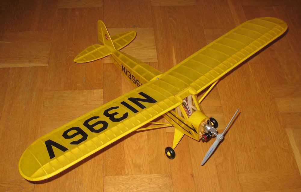

The smallest I've done so far is a Cub with a Cox .020 (PeeWee) engine in the front.

....built from kit ?
so nice!
Old 08-02-2010 | 09:23 AM
Mr Cox's Avatar
Joined: Jul 2007
Posts: 3,791
From: Karlstad, SWEDEN
Default RE: What about this conversion ? Swiss trim..
Yes, it is built from a local laser-cut kit and covered with litespan.

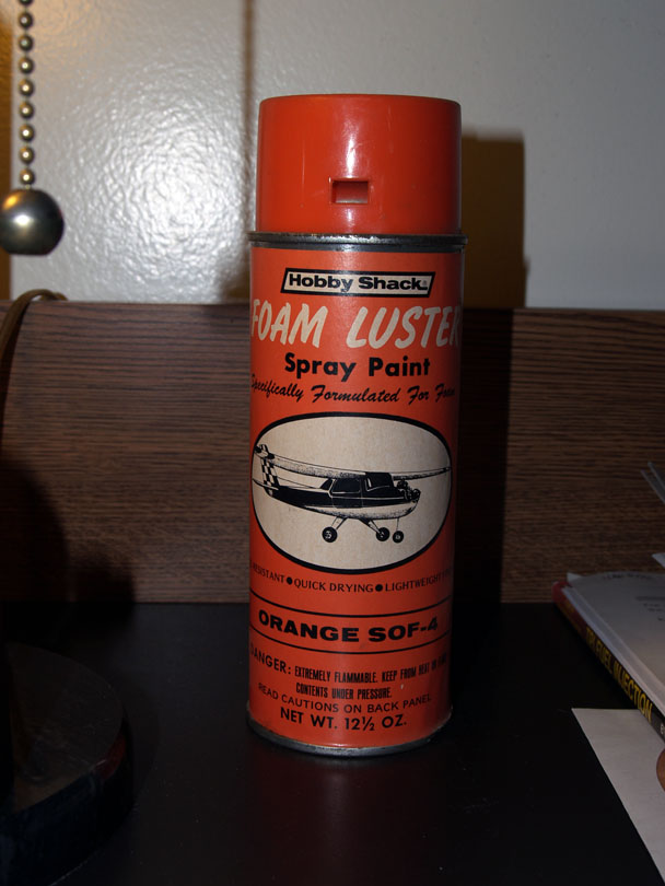

That said, I believe the foam has to be protected. It needs to be painted with hot fuel proof paint. At least, I remember having to purchase spray paint designed expressly for foam airplanes (foam safe formula) in order to paint them and make them fuel proof. In fact, I still have an ancient can of "Foam Luster" spray paint from Hobby Shack!
