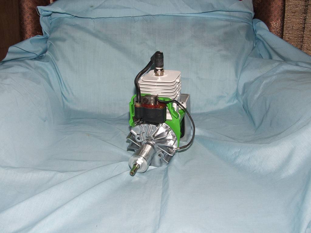

I've been working on this engine for a couple of weeks now and I'm about done except for putting the carb on and finding or making an exhaust for it.Also waiting for a couple of new rings for it.It's stock for now and as you see I like bling. I took off any unnessary metal and painted the case with 500 deg Chevy Grabber green engine paint as well as painting the cylinder with white 1200 deg paint.I bought a lightened and balanced flywheel off Ebay and also painted that with automotive chrome paint.I got the Homelite conversion kit from Wackerengines which has the mount,prop hub,rotator manifold and velocity stack.I have a Walbro WA 167A carb with an 11.11mm venturi and also a WA 167A that someone bored out to 13.50 mm,which I think is too big for this engine.I'll either buy or make a Pitts style muffler.I'd like to put the engine on a cut down version of a Senior Telemaster with a wing span of 84". I've only flown a plane already in the air, so I need to learn to fly.I figured I'd build the Telemaster into a SPAD,because it is tougher and easier to fix than balsa, then after I learn,then put it on a balsa plane.I built a SPAD Spadet LC-40 before and it doesn't take too long to build out of coroplast.I had a balsa Telemaster that I built ,but sold,so I have to start all over.
One thing I want to ask is what is a good plug to use on a Homelite airplane engine? I was into gas powered boats and used an NGK BPMR7A on a full mod Homelite marine engine. Oh ! If you notice the hole in the case,I have to get a plug for that .The engine was originally to be used as an r/c boat engine and the hole is for a pulse fitting to hook up a water pump.

Nice looking homie, is it 25cc or 30cc?
I like the green, need to get some for the motor on my (green) airboat.

It's a 30cc.I bought the green paint at Auto Zone.It's made byRust-Oleum and is a 500 deg engine enamel.The color is Grabber Green. Just waiting on the new rings and get a muffler.I sort of got tired of r/c boats,but wanted to stay with gasoline power,so the Homelite seemed like a good candidate for an airplane.I have another 30cc trimmer and a couple of 25cc that might turn into plane engines.I was going to turn my new Zen 260 marine into an airplane engine ,but will let it alone for now.

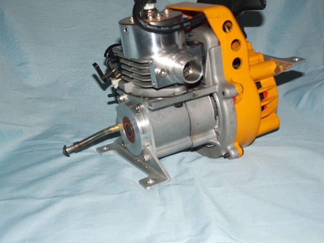

I got the WA167 on the engine using the rotator manifold from Wackerengines.Now I just have to decide what type of exhaust to use,a Pitts to put the pipes behind the engine or a canister on the side.I read that the Pitts with the two pipes is loud and that one with one larger exhaust pipe may be quieter.I wonder if anyone ever adapted a Team Gonads X can muffler to use on a plane using a Homelite or other weedeater. I used one on a boat motor and it was a little qieter than a stock canister muffler and had no loss of power.

Nice looking engine. I bet you can't wait to fly it.
I usually mount mine directly to the firewall with studs instead of using standoffs or a mounting plate. (Saves weight.)

The Zenoa G23 and 26 and DLE 30 mufflers will fit this engine

AV8TOR,Do you mean put the bolts through the firewall from the inside and into the backplate holes?Has anyone ever used rubber vibration damping mounts like used in r/c boats?
captinjohn,No plane yet ,but thinking of a large SPAD or maybe the coroplast version of a Senior Telemaster, until I get the hand of flying.Coroplast planes are tough and easy to repair after I crash.Later I'll go to a balsa plane when I get confidence.
w8ye,I don't know about the DL 30,but if the Zen 26 air is like the Zen 26 marine the bolt holes are at about 1 3/8" and the homelite is about 1 1/2" If I could make an adapter out of aluminum to mount them I might use one of those.

The Homelite 25 and 30 are indeed 1.5" w/10-32 screws whereas a Zenoa G20, 23, & 26 are 1.350" w/5mm screw holes.
But in most aplications, you can take a G23 header or muffler and oblong each of the holes to the outside 1/16" and it fits the Homelite.

I wouldn't mind trying a X can muffler if I could get someone to make an adapter with mounting holes at 1 1/2" onto the exhaust port and then have bolts at 1 3/8" to enter from the rear of the X can.The X cans have a baffling system that you can add or remove baffles. Sometimes you can find used ones cheap. http://www.davesmotors.com/s.nl?c=88...0can%20muffler

Yes. I use studs to mount the engine backplate, with nuts to hold the backplate on. Then I put large washers on the studs, and then the studs go right through the firewall and get washers and nylock nuts on the inside of the firewall. Most of us don't do any type of soft mounting. I have read that soft mounting causes power loss, though I have never done any testing personally to prove it. It will work fine hard mounted.
I got my last Homelite muffler from www.wackerengines.com Ask him to put slightly larger exit tubes than normal. I put larger tubes in one of his mufflers and gained 400 rpms.

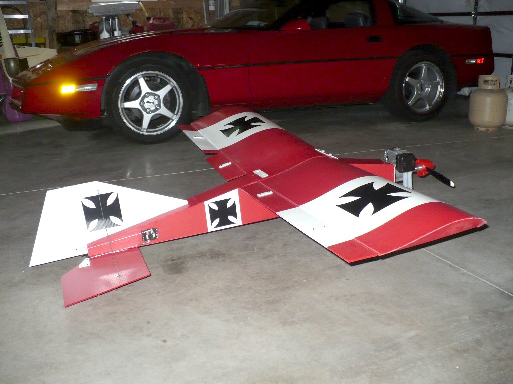

Here's an idea for a plane. Its an Ultra Spad Stick down sized to 25cc size with a hopped up Homey 25cc on it. Check out the muffler. Its a gutted stock housing with silicone extension tubes that normally go on a .60 sized glo motor. They snap right in and I put some high temp rtv on them.
