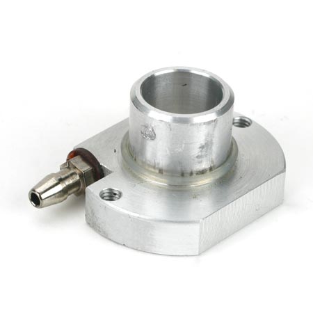

Old 07-01-2011 | 07:56 PM
Posts: 1,728
From: Little Elm, TX
Default RE: walbro or tillotson carb on ST 3000
This one from Horizon might do the trick, or you might be able to get it modified to fit that engine. I understand that it fits the carb.
Ed
Carburetor Flange 26GT
$14.11 [EVO30941321]

Old 07-04-2011 | 06:08 AM
My Feedback: (38)
Posts: 2,094
From: westbrook, ME
i understand ken . will the evolution adapter , from horizon ,in the picture, fit the st 3000 carb throat?
also is going to an electronic ignition on the 4500 , something i could do or would i have to send the engine to you?
