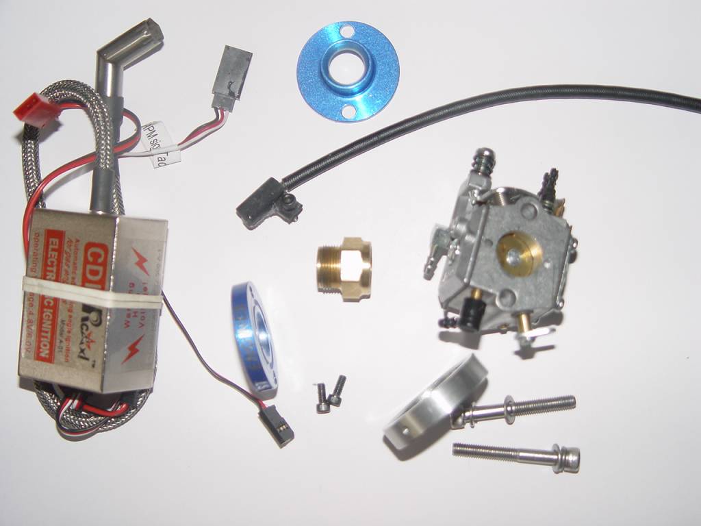

I will post pictures and details of the converion of a saito 180 developing and using an STE saito 150-180 conversion Kit
Regards
Max

Both engines work niece converted. Tomorrow will be uploaded video and pics
regards
max
Old 10-10-2011 | 06:43 AM
Maximiliano Galvez's Avatar
Joined: Mar 2009
Posts: 163
From: Mexico, MEXICO
Default RE: Saito 180-150 conversion Kit

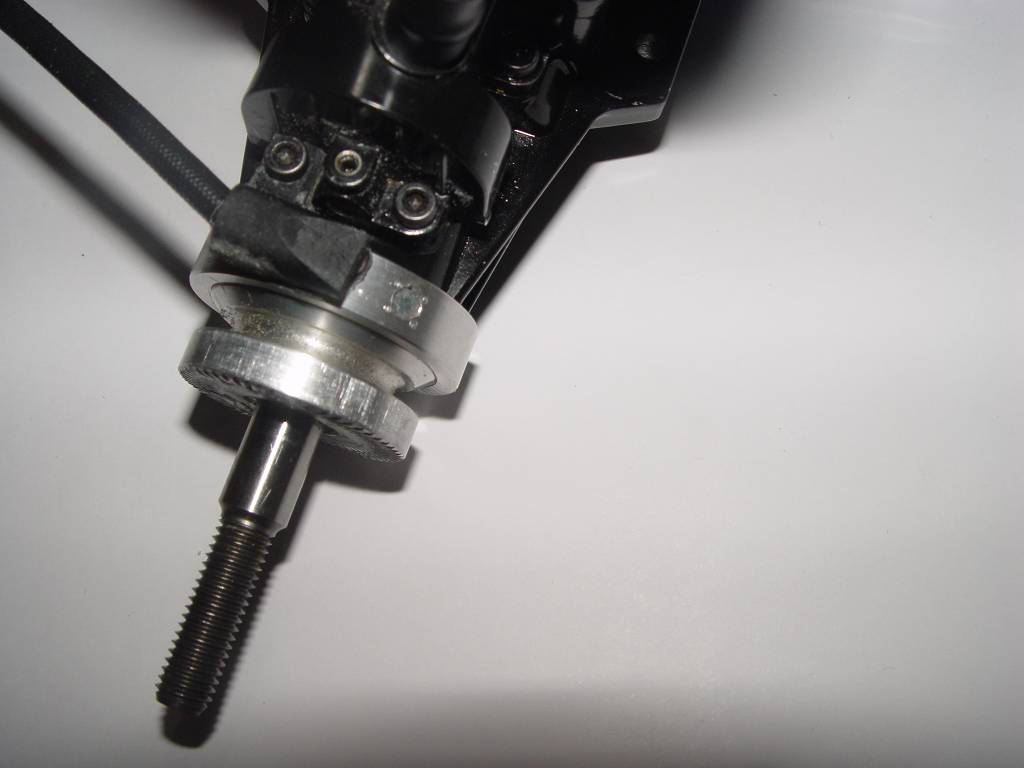

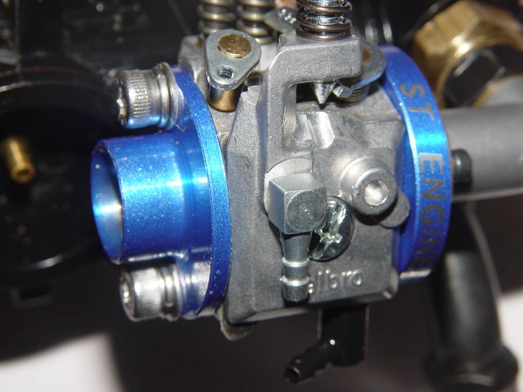

The conversion kit mounted
regards
max

How do you index the hub to the crank?

What is a model this WALBRO carb ? This link doesnt work "The conversion kit mounted "
Old 11-25-2011 | 07:21 PM
w8ye's Avatar
My Feedback: (16)
Posts: 37,576
Received 11 Likes on 10 Posts
From: Shelby, OH
WT-38 is the way to go with 180 Four Stroke.

Im using now tilotson 13mm ventury modified carb
can work any gas carb with the velocity intake
