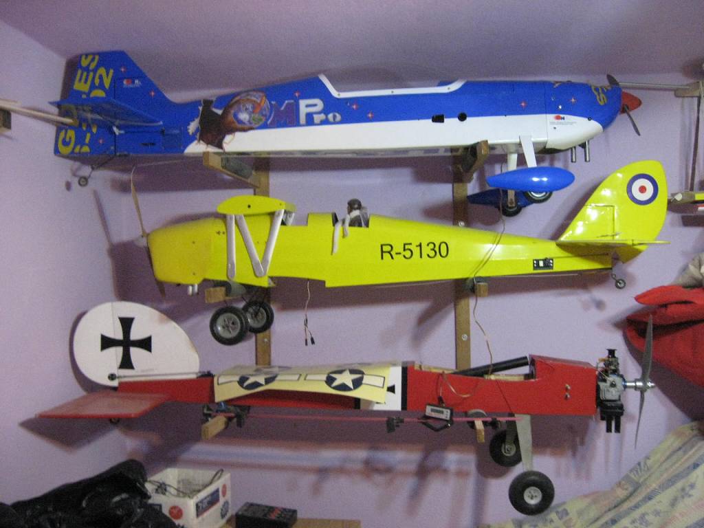

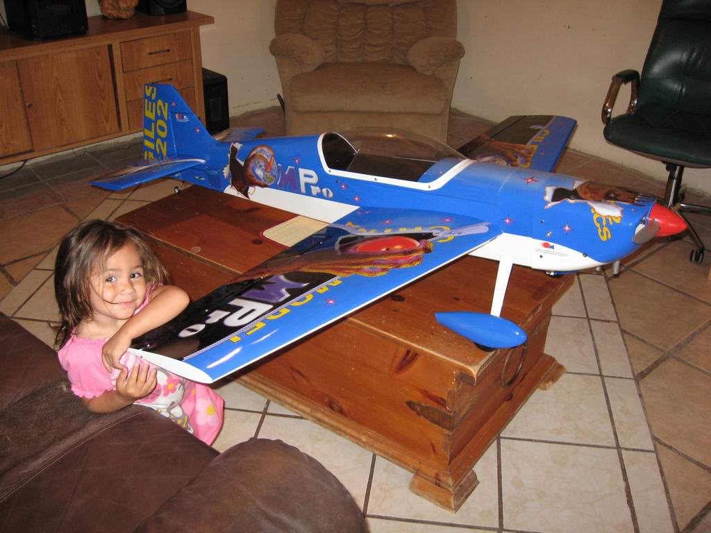

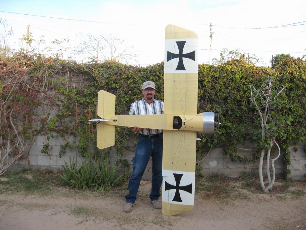

The 61" span Christen Eagle flew very nicely on a Homelite 30cc, as does the blue 72" span Giles 202. The big 76" span yellow Tiger Moth flies great on a Ryobi 31cc. The Giant Fokker Eindekker flew in a scale like manner with a Honda 31cc four stroke. (Would loop from level flight.) The Giant Stik has a homemade twin cylinder engine. It is made out of two Echo 24cc engines. A very short take off, followed by an aileron roll, then straight into a vertical climb is the usual take off routine for that one. In the old picture of mine with multiple planes, the 66" low wing cream colored plane has a Homelite 25cc in it, the Ultra Lite 120 has a Homelite 30cc in it, the 72" span Katana has an Echo 25cc in it. I also have a Great Planes Fokker Triplane that flies great on an Echo 23.6cc engine.
The conversion engines are slightly heavier and slightly less powerful than the latest commercial offerings for planes, but I sure get a lot of good use out of them in many different planes. (And spend very little money doing it!!) Until a fairly short time ago, basically ALL gasoline airplane engines were actually converted engines.
