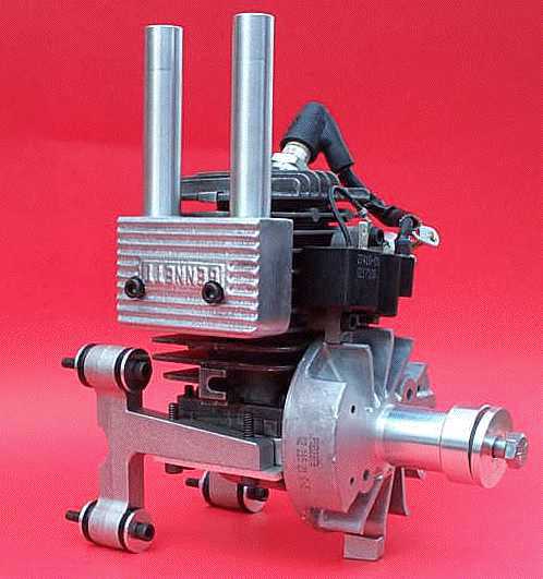

Got a decent deal on an almost new saw, at a local pawn shop, paid 50 bucks for it, and sold the bar to a guy standing there for 10 bucks, so i have 40 in the engine... Craig (psk560) came by and we ran it, runs great! <My problem is this, i see guys here are using the hangar 9 mounts, but how are you doing it, since the bolts that look like they would work for that are actually what holds the lower crankcase on? anyone got a picture showing up close what i need to do? Thanks!

You make two little adapter plates that fasten to these bolts and extend out to match the H9 mount. The pictures show the Dubro mount and a 33 engine.

That's perfect, I can't believe that didnt occur to me! thanks much for the info, i was racking the old brain trying to figure it out with no success! Do you know if the bolts are 6.0 mm? i believe some one in another thread id'd them as that size? Thanks again!
