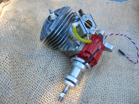

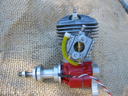

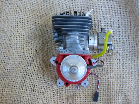

I still need to make a mufffler. I have not run it yet. 79cc. 4# 10 oz so far.

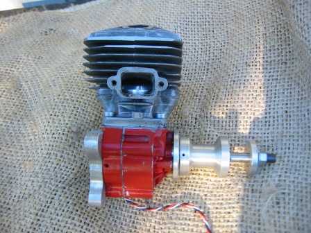

Very nice conversion.
Looking in the exhaust it looks ported?
Did you do the machine work?

I did not change the ports. I did all of the machine work. I was hoping to run it today but the muffler took longer than anticipated. This is my best looking engine so far. It just looks like a powerhouse, very svelt an purposefull. Hopefully the performance matches the looks.

That manifold is very similar to the one I made for my 62cc Stihl. But I am afraid you are going to find you need more heat insulation for the carb. That's what happened to me in testing mine....
The Stihls are like the Zenoahs; they really like to rev, so you might resist the very common urge to overprop it. Let it rev and you'll love it!

The numbers are in:
22x10 menz
7200rpm
6.1hp
I have not found the timing sweet spot yet.
