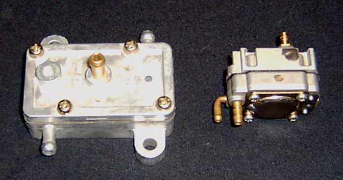

The one on the right is the one that I make out of Walbro carbs and use as a smoke pump. The one on the left is the big heavy bulky one that B&B sells. It is not hard to make; all you need is a couple of pressure fittings and the drill and tap for them.
Walbro used to sell a little pump just like this for use on go karts I believe it is. The Walbro number is WEP but I just searched the Walbro site and couldn't find it. Instead, I found this: http://www.walbro.com/media/5980/FPC...%208-20-12.pdf

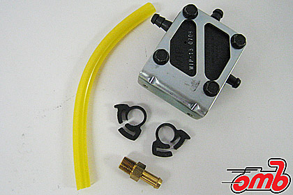

NGH has a small external pump regulatorthat they sell for their little NGH 9cc gas engines. it isn't priced all that much either and it uses Walbro parts too. One could just as easily remove the regulator parts and use it too. HiModel sells the engine parts. Sometimes you have to do a little fixing to the pump/regulator and other times you don't though.
Walbro also has this fuel pump too<font face="Arial">:
They say it is for four stroke engines but it seems to me ot ought to work for small 2 stroke gas engines as well.
WalbroWIP-13-1 and WIP13S.
</font><div align="justify"><font face="Arial">
</font></div><div align="justify"><font face="Arial">Fits Walbro models 3020, 3027, 3028, 3029, 3043, 3044, and 3045 series pumps.</font></div><div align="justify"><font face="Arial">
</font></div><div align="justify"><font face="Arial">Not compatible with greater than 10% ethanol fuel.</font></div>
