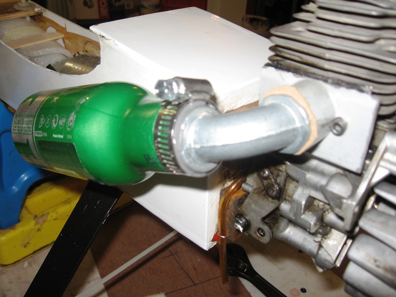

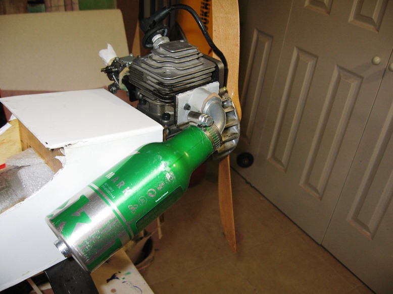

Hello everyone, good morning
I made my self a homemade muffler for my 33cc weedwacker engine out of some electric instalation general use materials for the header, and an aluminum bottle of Heineken.
Here are some pics.
Regards.
VĂ*ctor.

That's a neat fabricating job, but I'd worry about vibration breaking it off at the header. That's an awful lot of mass hanging out there to shake when you start that engine up.

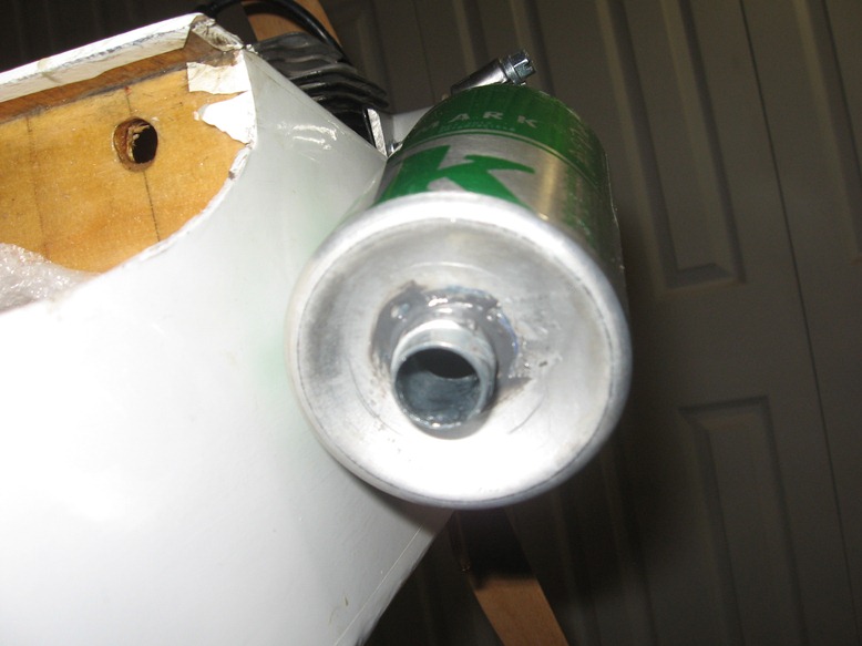

Good job. What is inside? What did you use to seal the stinger at the outet? Thanks.
Old 02-01-2013 | 09:48 AM
Joined: May 2003
Posts: 353
From: Mexico city, MEXICO
Default RE: Aluminum Bottle Muffler (Pics)
Hello
Theres nothing inside.... this muffler was made with the intention to have a low restrictive almost free flow muffler wich will allow me to maintaing same RPM´s I was getting of this engine with no muffler but being able to lower down the noise.
I´m hoping to have a little increase in RPM´s .......let you know on Monday after trying it on Sunday.
The stinger was sealed with JB Weld.
Regards.

Hello Everyone, very good results with this muffler.
Maintain same RPM´s as the ones obtained with no muffler ......7,500 RPM´s with a 18x6 wood prop.
In terms of noise, it really makes the engine very very quiet......comparable to a muffled 120 size commercial glow engine.

It works pretty well, it hasnt broke and I have already some 20 flights on it after installing this muffler.
The only extra modification I made was some more exhaust holes to make it even more less restrictive (Next one will have a bigger diameter output)
Im Getting between 7,700 and 7,800 RPM with a 18x6 Turnigy wood prop (I fly at 2,400 meters over the sea level)
Regards.

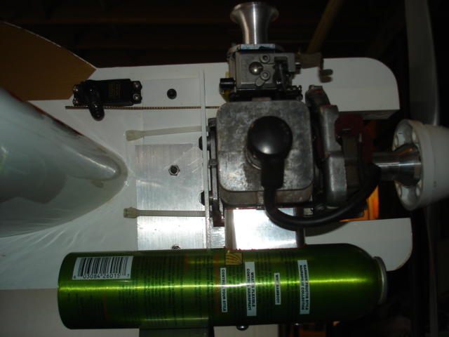

I used an aluminum hairspray bottle.
Jeff

A member of my club has a DB meter, the Homelite 25 with the above hairspray muffler is 80 DB at full throttle (very quiet). I also measured thrust with a Rapala fish scale, 10 lbs of thrust with a 17x8 Xoar prop.
