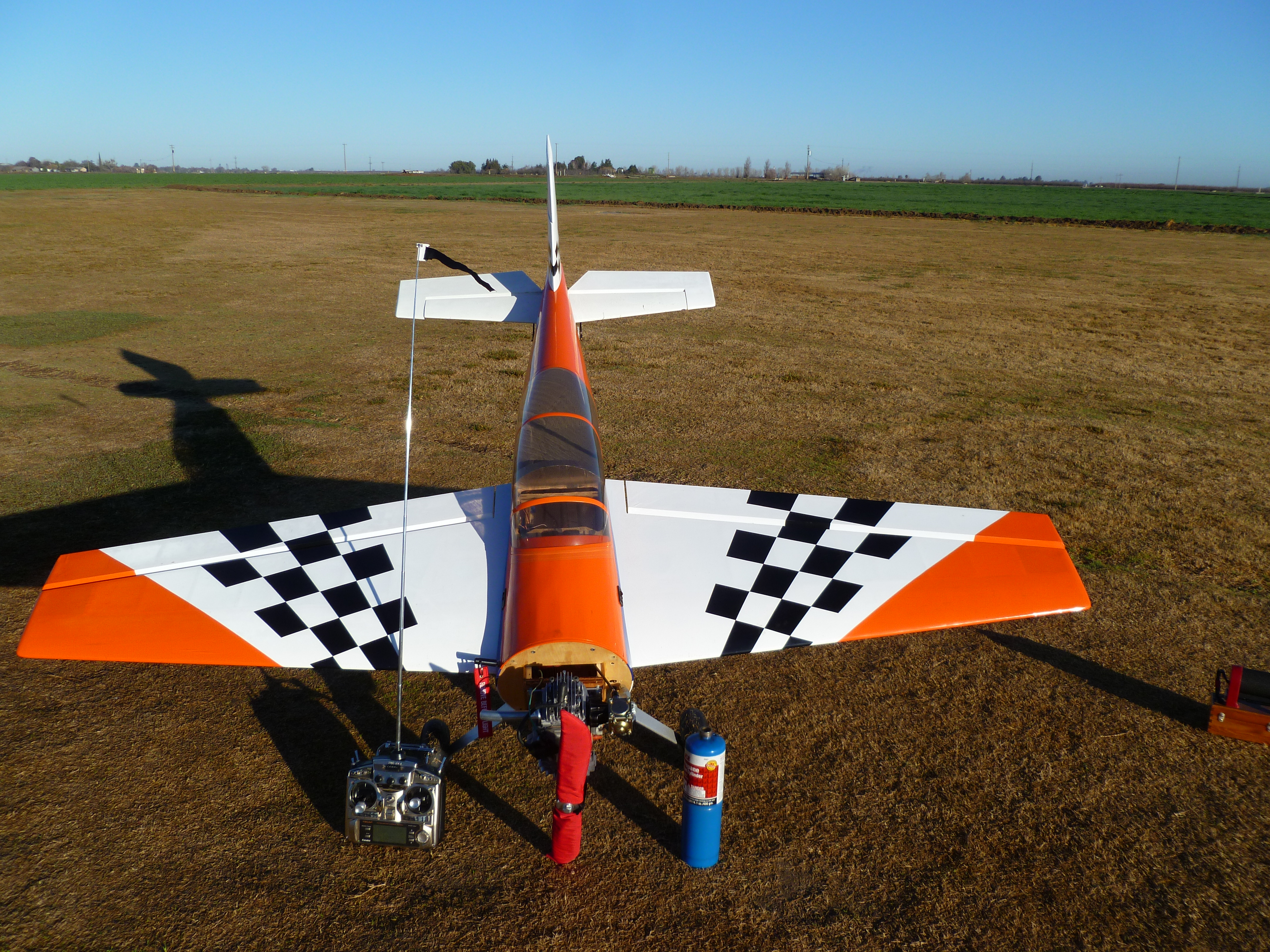

This morning I flew my propane powered airplane for the first time.
I have seen full-size powered paragliders powered with propane, but I have not seen anyone else fly a piston engine R/C plane on propane. I think this is a first!
I converted a new 40cc Briggs to R/C, then adapted a Lehr propane carb and regulator. (I had converted a Lehr 24cc engine first, but it had no power, so I moved the carb to this engine.) Power is moderate, 7000 rpm on 18x6 for a static thrust of 14.5 pounds. (20x8 yielded only 5300 rpm) A standard 14oz propane cylinder resides in the fuselage area normally used to house an expansion exhaust. It can be swapped out in a couple of minutes, and can be refilled at home.
The airframe is a 30% Yak that came up for sale cheap. (I hope to build more of a "floaty" airframe for this engine someday.) The all up weight of the Yak is 19 pounds 8 ounces. Take offs look just like the Spirit of St Louis, but it does fly! The engine starts easily, and runs reliably. With propane, throttle response is instantaneous.
The purpose of this exercise was merely to see if I could make it work!

Looks like a wet sump oiling system. Note the oil cap with the two posts on either side of the cap. Very common among small Briggs 4-stroke engines.

Yes, it's wet sump. I don't know the run time potential yet, my guess is 90 minutes or more with this airframe. This is the worst type of airplane possible for duration testing, as you have to really fly it all the time. For that I would prefer a huge 3 channel design that I can trim to fly in a big circle overhead, hands off. I could save some weight if I modify a propane cylinder shorter, as I carry much more fuel and tank than needed for normal flying.
I have also a converted Honda GX35 (also wet sump) that doubtlessly would have made greater power on the propane, but I wanted the novelty of flying a plane with this flathead engine.

Pretty neat. I was wondering when someone would get around to trying this. Looks like besides your propane tank, that regulator could do with some downsizing and lightening as well. The Honda engines work pretty well, and are all position, but low on power. I'm guessing they have more power than the flathead though. I'd have to look back through my posts to see what my GX31 that I converted turned. For real fun, try a Stihl Four Mix engine, as they are quite powerful. Well, on second thought that wouldn't work without coming up with an oiling system because they use oil in the gas like a two stroke.....

Don, I am more surprised than you by my choice of airframe! This one came up for sale cheap at the club field, and I thought I would give it a try. The 3D guys probably think this is a sacrilege! By removing one stab (and the wings) I can actually get this thing into the Jeep! The rudder is at the windshield and the prop is at the tailgate! 1400 sq in sounded like a lot of wing area, but now I long for about 2500 sq in... You know me, I prefer old timers and Lazy Bees.
