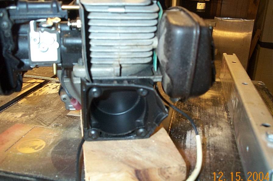

I found a post where someone was converting one into an r/c boat engine and relocated the starter motor up and to the side instead of the engine bottom to get the engine lower in the boat hull.Pics below.
