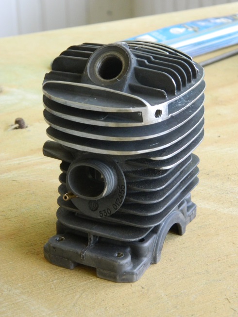

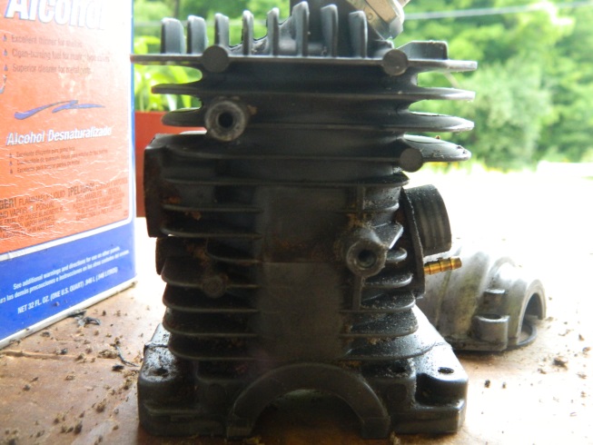

Hi all. I have taken on a Poulan 46cc conversion (model 4620 avx, essentially same engine as the 295).
I'm new to gas (never done glow either, just electric) but have run chainsaws for some time.
I'm pretty new to this forum but It seems like the place for this stuff. I have many questions, but I'll try to limit them and search out most on my own.
A couple though... I decided to grind the fins down a bit, mostly for aesthetics. Should I and/or can I seal that exposed aluminum to prevent corrosion? I would like to avoid painting the whole head. Maybe some sort of bluing agent or real simple seal/oil?
I opened up the crankcase (clamshell) to install a Bowman ring. Anything special to resealing it? Yama bond perhaps?
Next will be figuring out the carb adapter and prob hub. Probably ordering the hub...
Here are some pics. I'll add as it comes along (weekend project ya know). I'll be using stock mag as my goal is really to have fun converting and to do it cheaply but hopefully as nicely as possible within technical and expenditure limits. Thanks for any help!
Pre breakdown
Pre fin grinding
Ground. Waiting for porting and all the rest.

It isn't necessary to paint or "seal" the aluminum. It will be fine just the way it is now.
On any gasketed surface with these small two stroke engines I use no sealer at all. It's not necessary if the gaskets are good, and small bits of sealer can get into the carb pulse port, the spark plug gap, etc., so I don't recommend using sealer. The only time I use it is on some engines I leave out the base gasket to lower the cylinder for more compression and then I do use Yamabond in place of the gasket. It won't hurt though to carefully put a very thin layer of Yamabond on one of those crankcase halves of that Poulan.

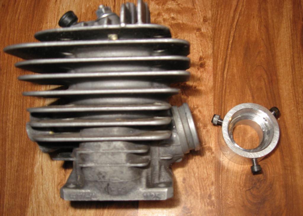

Where to get a prop hub made? I am not up for machining that particular piece. I know I've seen a few options posted somewhere, but I can't seem to find them now and/or the business no longer is around. (Carr is one I do still remember).
I will be using stock magneto if that makes a difference. (I know lots of people reccomend to just go electric, but I would like to go through the experience of the magneto; ater perhaps I can know the difference in performance first hand... and I have a very tight budget)
There is really no money to be made in manufacturing conversion parts, so businesses come and go. Wacker Engines used to be a good source, but as far as I know he is no longer doing parts. I believe Carr Precision is still going, as is www.lambertsrc.com. Can't think of any others at the moment....

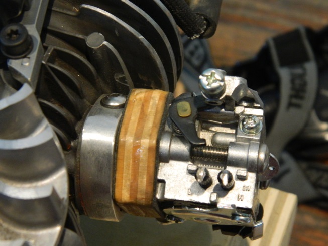

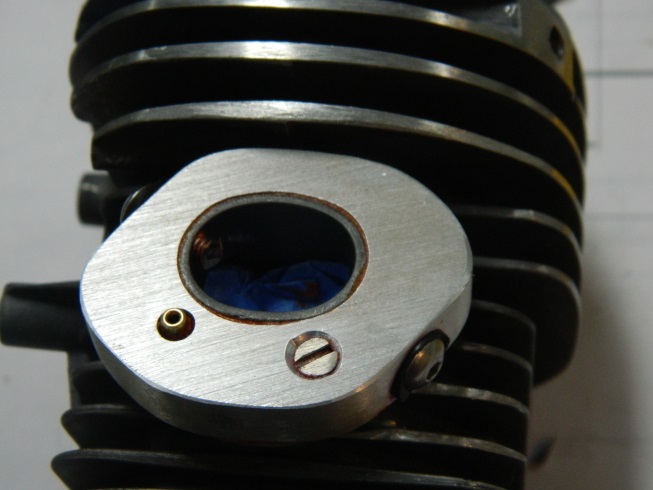

I am currently building the carb adapter. I've gotten a little discouraged discovering how expensive the recommended materials are (G10, or 1/2" stock aluminum). I think I am going with aluminum, being cheaper, with a separate 1/8" or so insulator. I like the sounds of wood due to cost and insulating properties. But yet again finding high quality plywood of 1/8" or so thickness would probably mean ordering it on-line, paying for shipping and all that jazz. Could I either use just solid wood or laminate my own perhaps. I'm all set up with a wood shop so working with the raw stuff is no prob. Hard or soft wood? What is best to coat the wood with to protect against gas (epoxy?)

So here are some photo updates.
I had a quick chance to attempt at fire up, but to no avail! It is not pumping fuel. I have some thoughts but not sure what the exact problem is.
It was a quick attempt a fire up, didn't pre-fill the fuel line with fuel or anything.
--Can these types of impulse driven carb pumps pump fuel a decent way (say a foot) through a dry line, or will I need to pre-fill the line? (no primer bulb on this carb)
--Will rather gentle turns of the prop pump fuel or will I need to get a starter on there. (as an aside, how does a starter not simply unscrew the prop hub (rh threaded) as opposed to turn over the engine?)
-- The saw did fire before break down, but the carb sat dry in-doors for maybe a month or two. Would that be enough to warrant the pumps drying up and needing a rebuild kit? I would rather trouble shoot to see if the issue is my carb adapter, the carb, or the tank plumbing, but I am not sure of ways to know if the carb pump is receiving impulse and/or is pumping... Anyone got any good tests to see where the breakdown is happening?
With the throttle open and the choke tight shut, you should see fuel move through the fuel line towards the carb with each hand flip of the prop. The pump should be capable of pumping fuel 3 feet straight up if all is working properly. To answer your questions, yes, sometimes dry carbs are difficult to get moving the fuel again, and yes, your carb might need a rebuild. The diaphragms inside can dry out and get stiff in a short amount of time, especially if left dry. Also, these systems will not tolerate even a tiny air leak in the supply lines. A slide on connection can seem fine, but leak air and then the pump will not work. You also need to be sure that your pulse hole in your carb adapters are lined up. That is where/how the fuel pump in the carb gets it's impulse to move the diaphragm and pump fuel. Your adapters look nice, but you may still have a problem. I made up a similar setup on a Stihl 62cc chain saw engine that I converted. I had problems with the carb mounting screws transmitting too much heat to the carb. It made overall tuning and hot re-starts difficult to impossible. I had to redesign my carb mounting so that there was no metal to metal contact anywhere to transmit engine heat to the carb.
