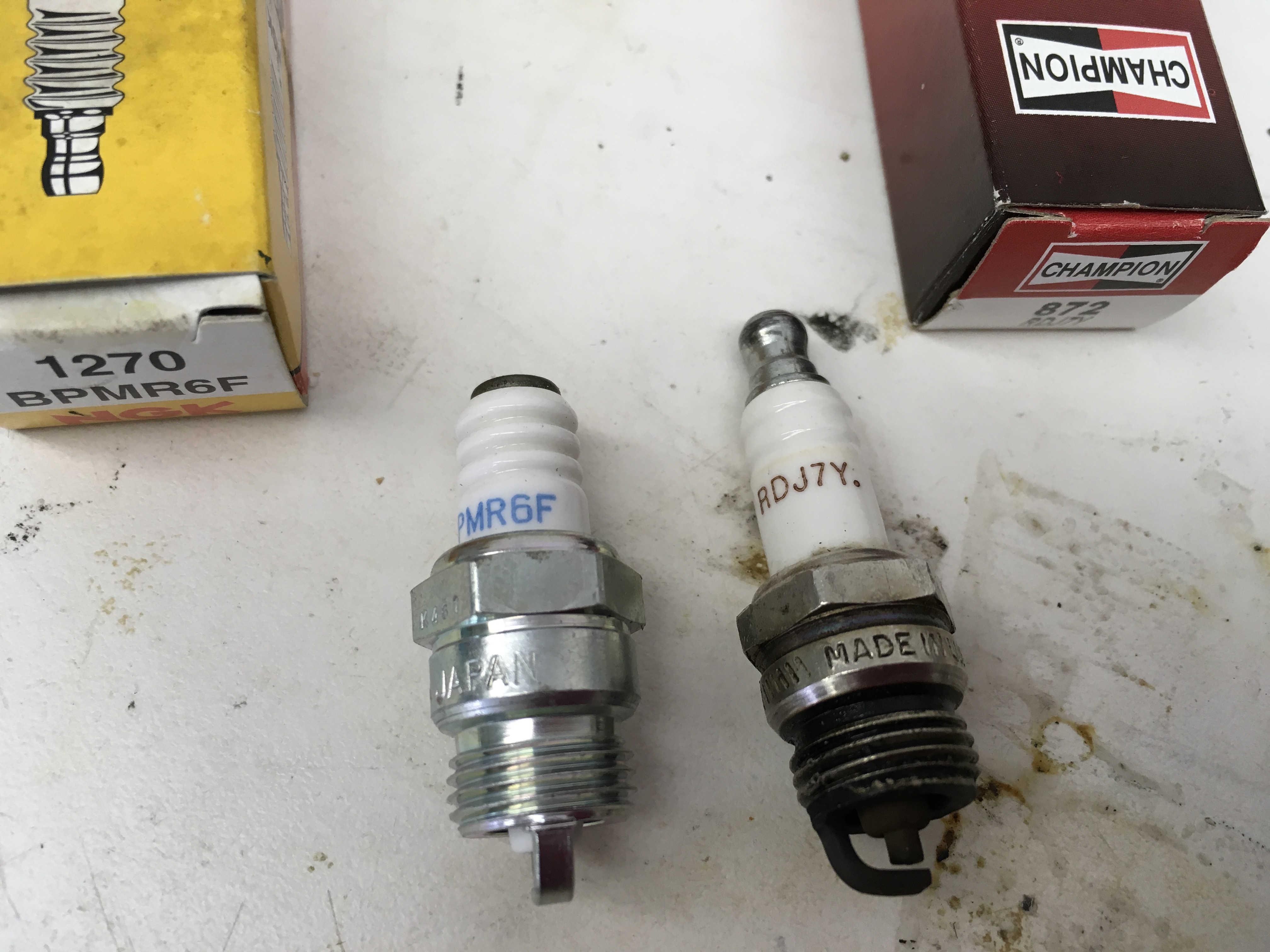

Thanks Av8tor. Changing plugs sounds like a smart precaution.
The local NAPA auto parts store had the Champion plugs.
I had previously purchased the NGK replacement 1270 for the Champion RDJ7Y,
but the NGK appears to need a different spark plug cap.
Which NGK plug do you use?

Whatever old thing lying around. (Just kidding.) I do know people like that though, and my brother is one of them. Then he wonders why engines don't play well with him....
I have a bunch of engines, so the answer varies. I don't remember the NGK specific numbers right off the top of my (old age) head. Besides heat range, there are two basic variables in the plugs for most of our engines; sealing surface and hex size. The sealing surface is either taper seat or gasket, and the hex is either 5/8" or 13/16". Hex size is important for engines running the newer ignitions with a metal cap as they only accept the size they were designed for, and sealing type is important on most engines. A Homelite will accept either sealing style plug though, and with the magneto, should accept either size hex as well.
I just looked at your pic closer. As I recall, that's a correct number, but there's something wrong with that plug. Either it had a mistake in manufacture, or the connector got broken off.
Of course, make absolutely sure no matter what that you use a resistor plug, especially with that unshielded magneto. (NGK's with an "r" in the number are resistor, as are most brands, but if in doubt be sure to check.) Sparkplugs.com is a good plug research site.

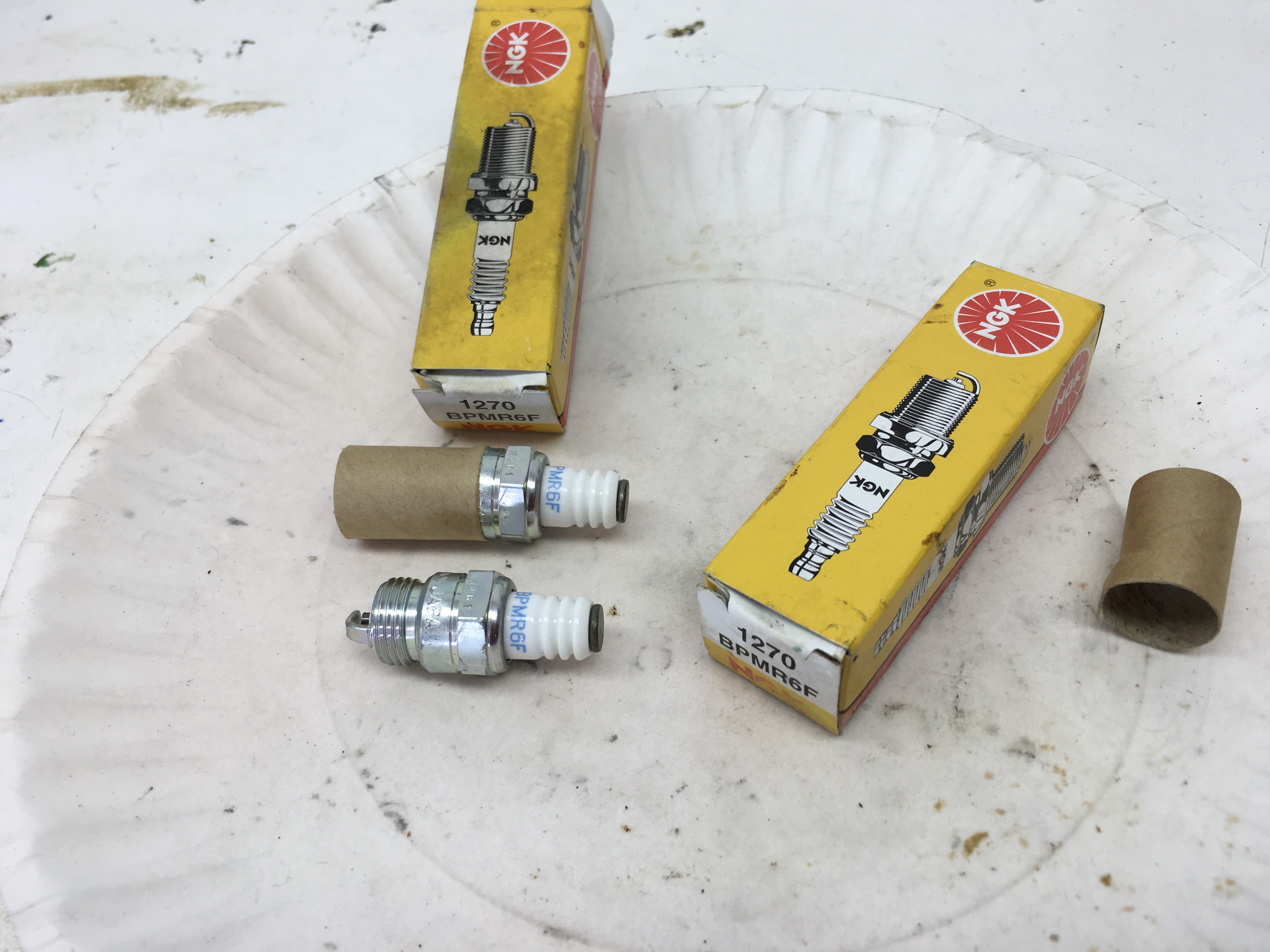

Av8tor, thanks for the info.
Both of my NGK plugs have the same flat tip.
Don't remember which online hobby place I bought them from.
Anyway, just ordered the same NGK plug number from CH-Ignitions.
Can't wait to see whey they look like.

That's bizarre. I've never seen a flat tip like that. I'm rather sure it's a manufacturing mistake. The CM-6 plugs have a flat top, but they have a receiver groove in the flat top.
There are two types of the normal top connector. Some are made as part of the plug, and some are the same size and shape connector, but the connector itself screws onto a stud that comes out of the plug. If you have one of those lying around, maybe you could cut the stud off and drill and tap these plugs to accept the stud and screw on terminal. You would have to be very careful how deep you drilled into the plug tip though, so as not to punch through and damage the resistor inside. Probably not worth it for the price of a plug unless you're bored....
