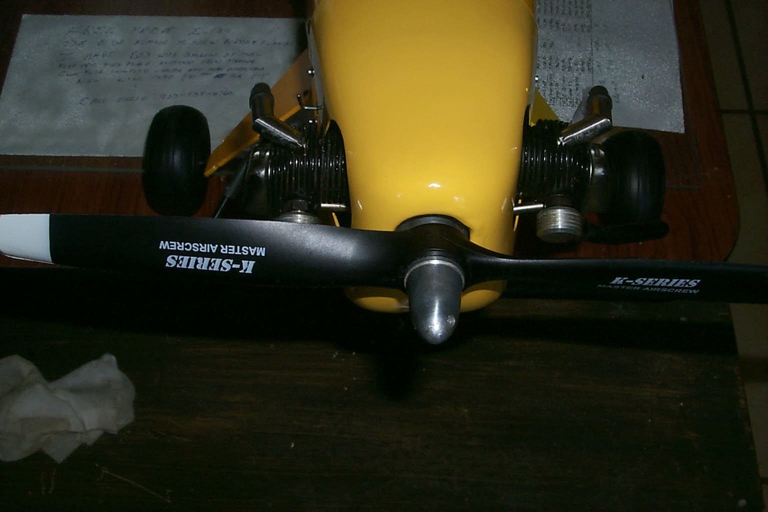

Thanks Jim for the good information on dealing with airflow and cowls. I did not get to the field yesterday but did test run the engine at home... running it for a 6oz tank of fuel for 33 minutes continuous without problem. Noted however is that ambient temp was 56° rather than the 70° the day the problem manifest. So... maybe the problem is cured but warm weather testing is needed.
A couple of pics of the cowl.
I could not find the site I was reading about air dams, I don''t understand that no other site came up on the lists for air dams for piston powered engines, all that came up was for turbines and front air dams for autos, I don't get it !
any hoo, your engine in that photo looks so neat with the jugs sticking out
