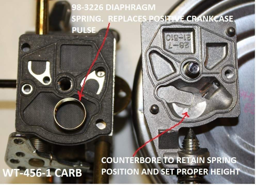

Default Walbro fuel pump return spring
For your reference, Dan.

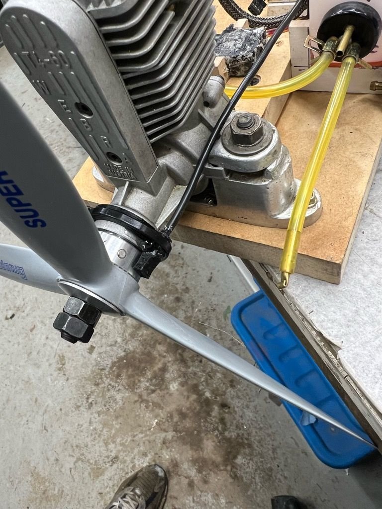

As soon as i started reading Bert and Lonnie' s responses - it jogged my Memory on this subject.. on my 69 Camaro I remember running the cam Timing advanced.. It was the DZ 302 engine and had a copy of the "Stage 2" solid lifter camshaft. Being a short stroke - big bore version of the chevy small block it really liked to Rev. Running the cam advanced (variable keyway settings) made it more "street friendly" and restored some low end grunt. It still didn't really come alive until 4000 rpm though - but it helped. Funny how you forget stuff.
Got the bearings changed - was tough to pull the piston pin to remove the rod (one piece case) but got it.. Everything looks great inside and can tell it has very little runtime. Got a replacement prop driver almost done for the magnet mounting- so I can keep the "stock piece" intact.

Prop driver done. Might get to try a bit of “petrol” this weekend
That is some skillful work right there.

As much as it pains me to say this I must leave this group….. I have thought I could get along and not have it affect me that dramatically….. but I must go before any further suffering occurs.
I just Ty-Wrapped a sensor on. 🤣🤣🤣. ***!!!🤣
Can’t believe how well it worked and how well it holds. Tightens it a bit to much and had a heck of a time adjusting the timing!!!!

I hate to say I told you so...
with exception of the radial and the Wankel, ALL my engines hav tie-rapped sensors...
Welcome to the dark side!

And you have a printer and abs filament too. My god, man. What is wrong with you.
drank toooooo much kool-aid!!!!
Actually this is a printed holder. The wrap goes through a bolt hole and around. I think I will try a printed design actually made for a tie-wrap to be the fastening device. The wrap method actually strengthens the whole printed mount and does away with the bolting holes which are always the weak spot on a printed one
no bolt holes on mine except the clamping bolt for the bracket. i pull the hall sensor out of the stock holder (actually, i never insert it into the stock holder) and place it into my custom sized bracket.
