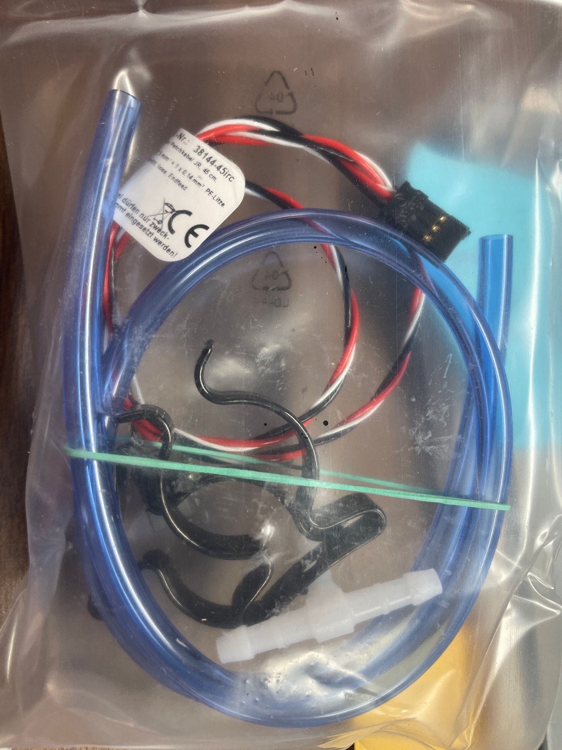

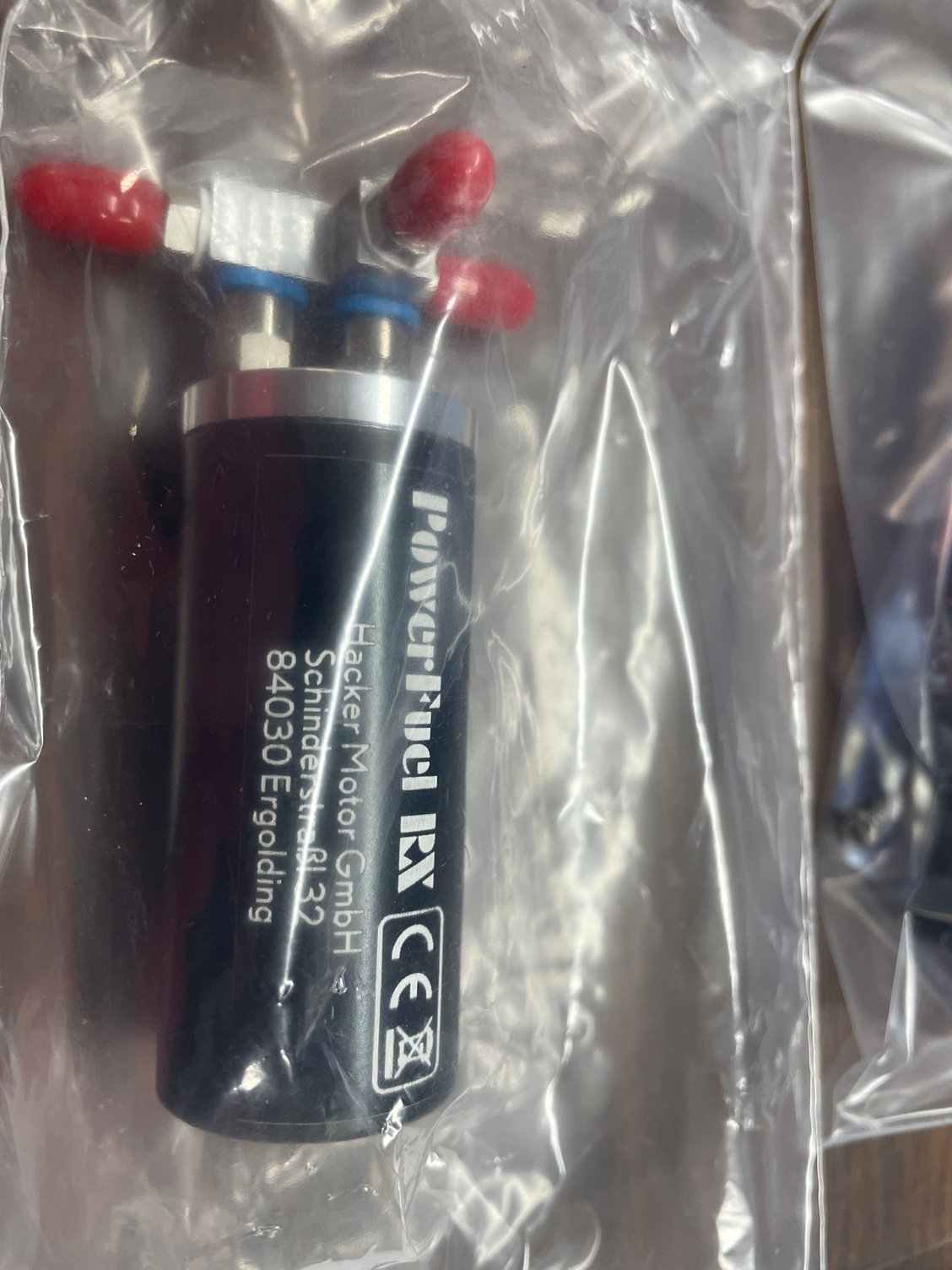

Adrian used an "APS PUMP" according to his invoice. See attached pics of the "POWERFUEL RX-U V2 SPIRITPUMPE" which he sent with my FA-325R5D, (not yet installed) but he did make a short video of it running in his shop.

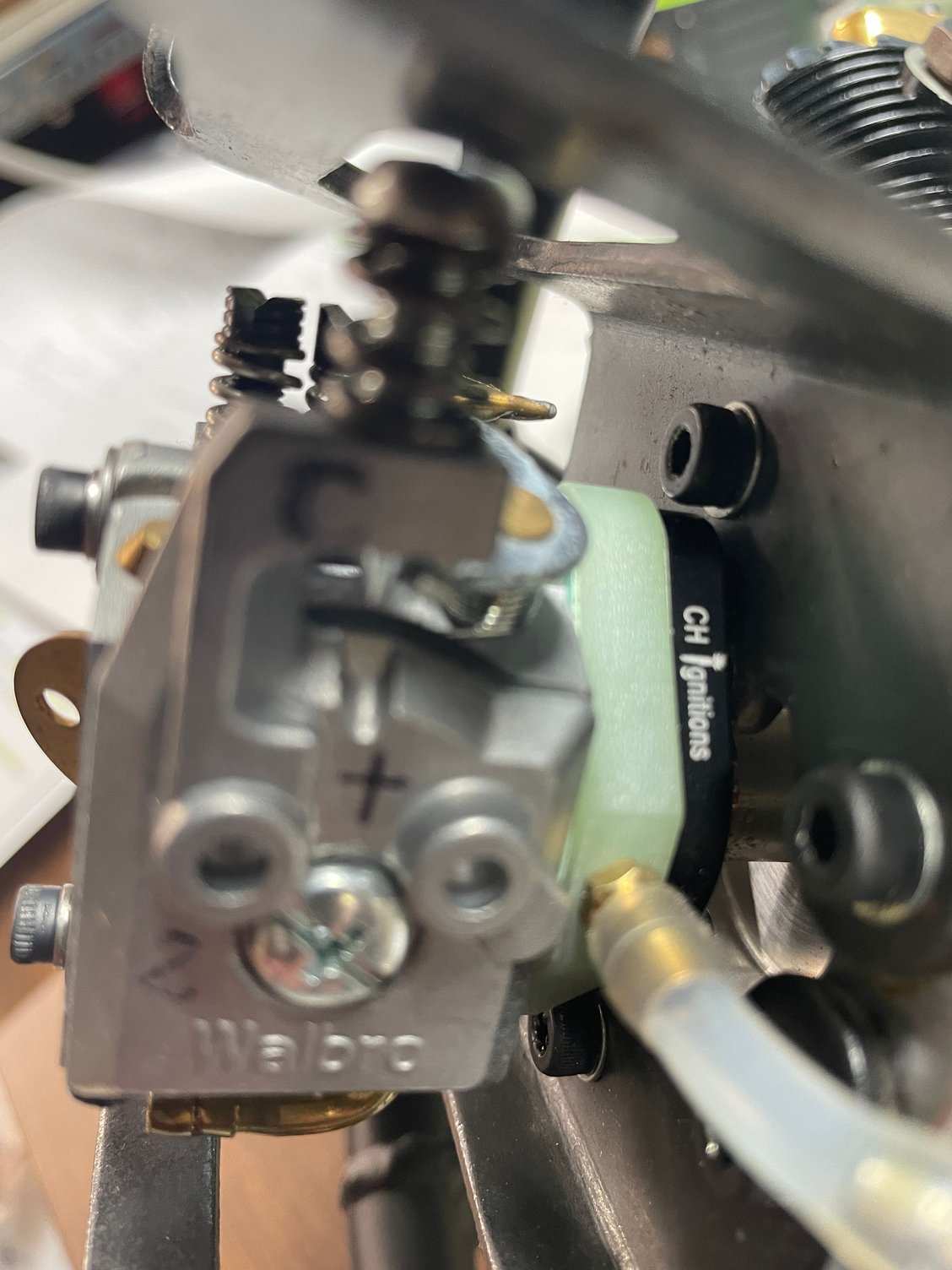

The carb is a WALBRO. I think it is the factory original, but Adrian has added part between the carb and the intake on the engine. See pics.

Appreciate your response. Adrian sent the conversion parts but did not install or run my 325. I have had no good fortune with it this far. I am considering going back to the glow carb and methanol. I have messed with the walbro till frustrated. Worked with Adrian to no good solution. Hope yours is working to your satisfaction.
Hey Brutus, if your still out there, are you using the stock glow carb on your 325? And does exhaust pressure ( via a tap on the exhaust ring) provide enough pressure to run it without the APS pump?

I do not have the Saito 325, but the ASP FT400, and yes, using the stock glow carb, with as only modification WRT carb the main needle O-ring, plywood thermal isolators between engine block and the carb/header.
Since at low RPM the ASP, because of the layout of the intake arrangement suffered from oil separation in the intake tract, causing the vast majority of the oil only reaching one or two cylinders, I drilled a few cheater holes in the header elbow that at low RPM (high intake vacuum) blow back and atomize that oil towards the centre of the intake.
I am using indeed muffler pressure, and provided the tank is as short as possible behind the firewall, this allows a totally troublefree fuel supply, from idle to full throttle in all orientations.
It runs idle with the nose vertical, and will accept full throttle from that position without issues.

I have tried both the APS programmable, the APS original non programmable, and the MicroPump Great Britain pump. With the Walbro carb and a number of inlet spring changes in the walbros to no avail. I have become so frustrated with this conversion i am now waiting on parts to restore the intake and carb back to methanol. Hopefully once back on methanol the original exhaust ring tap will solve this issue, with the spark ignition.
