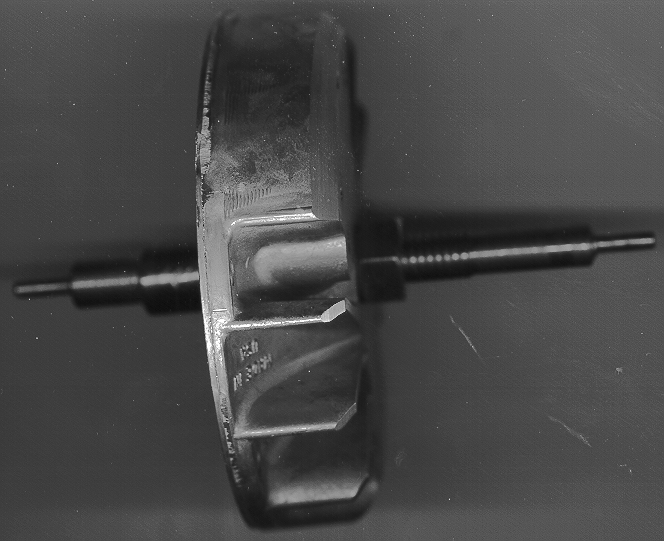

I have comments from some of you weedies where you say you balanced the flywheel.
How did you do the balanceing?
Here is how I balanced mine.
Lee Belew

I use my DuBro TrueSpin - best darn balancer I've used. I've also got the Great Planes magnetic one, but it's good for only very lightweight stuff.
I stuff a wooden dowel into the flywheel center hole, then drill a hole through the dowel to accept the balancer rod.
