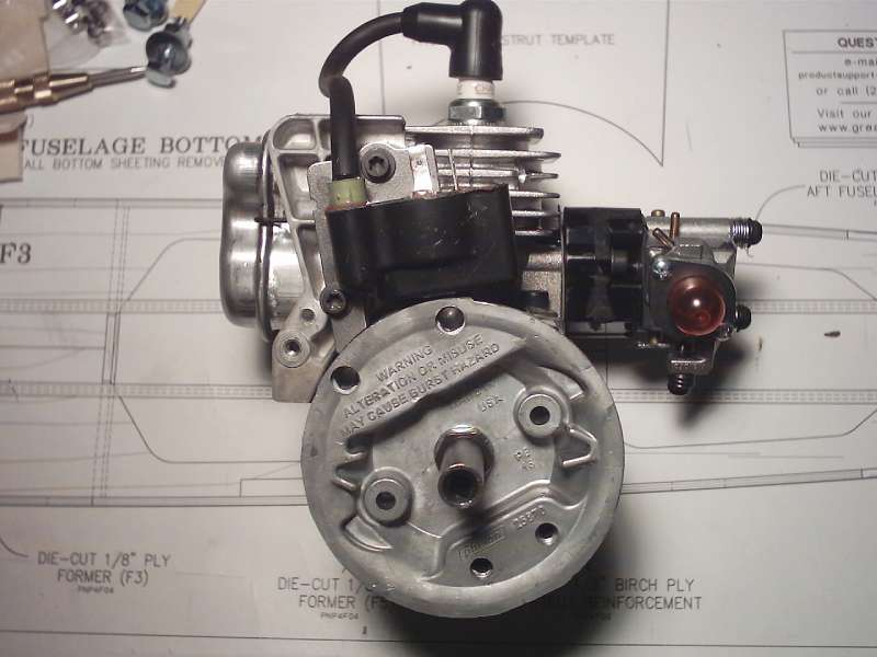

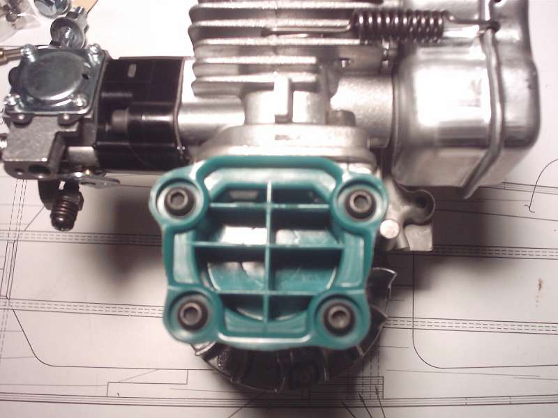

Old 11-19-2003 | 10:07 PM
teufelhund's Avatar
Joined: Sep 2003
Posts: 284
From: Whiteville NC
Default RE: Weedeater 25
Hey Riterudder, here is what I have done so far.Thanks for the info Mr. Cub, I was leaning toward the stingray or the 4*.

Old 11-20-2003 | 10:27 AM
Joined: May 2003
Posts: 13
From: Santa Rosa, CA
I have done this conversion recently. How did you get the starter pins, springs, and tabs out of the flywheel? I was afraid I might crack the flywheel if I forced them to much.

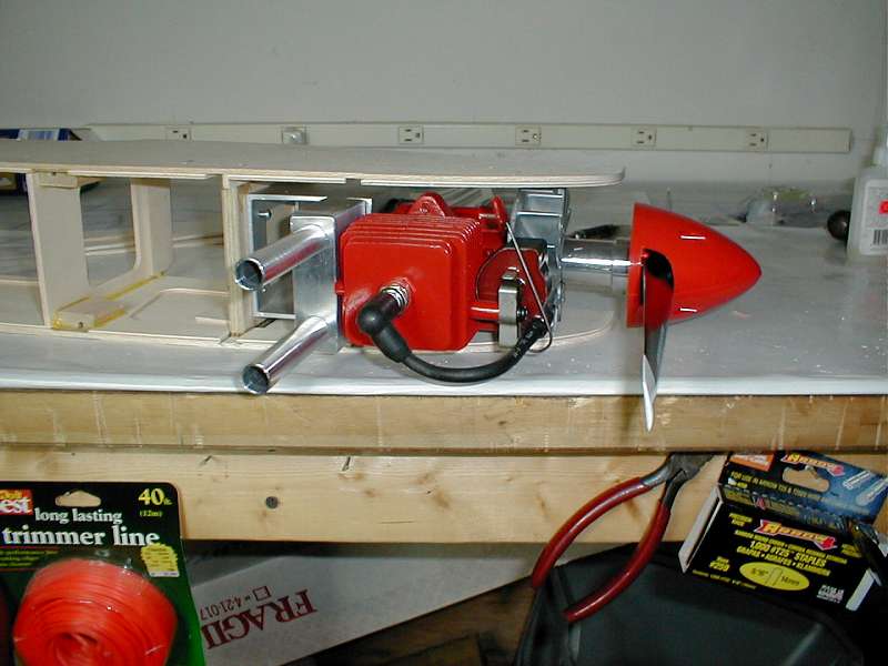

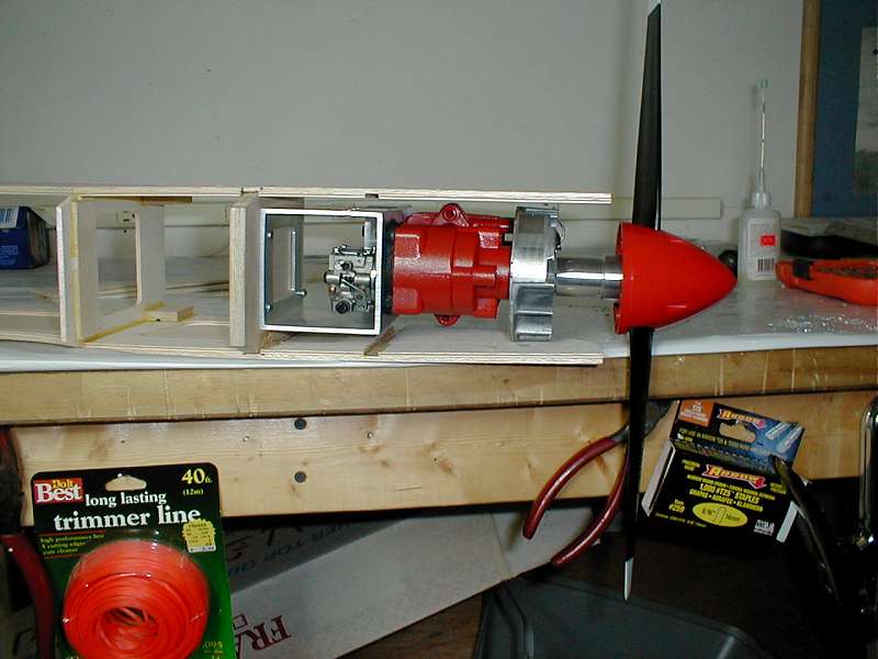

jstanton's Avatar
My Feedback: (14)
Joined: Aug 2002
Posts: 3,257
Received 26 Likes on 26 Posts
From: Millington, TN
Teufelhund
Here are a few pic's of how my Ryobi conversion fit into the stingray 120 I am building. I hope it gives you the information you need to decide on weather your weedeater 25 will work.. I had to move the firewall back 3" for the Ryobi, but you my not have to move it back as fare using a weedeater 25. The carb being on the side of the engine my present a little problem though with the cheeks of the fuselage. Hope this helps.

Old 11-20-2003 | 04:00 PM
Joined: Aug 2003
Posts: 831
From: Seymour, IN,
heliair, drill from the back side and punch them out. Piper
Old 11-20-2003 | 05:51 PM
teufelhund's Avatar
Joined: Sep 2003
Posts: 284
From: Whiteville NC
Heliair, I took a 1/8 punch and put the flywheel on two blocks of wood then carefully tapped the pins a couple of times. Believe it or not the friction fit was not that tight. I think I tapped them both twice before they fell out. Just don't let the punch come in contact with the flywheel itself. Good luck!
PS
It works better if you use a spring loaded punch to make an indention in the pins first, so that the 1/8" punch doesn't slip.

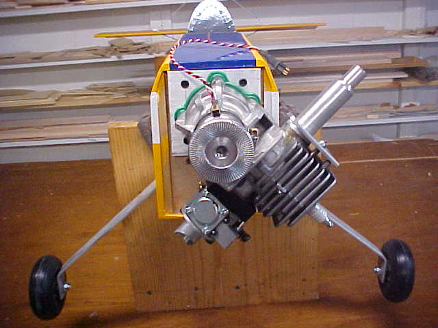

Old 11-30-2003 | 04:51 PM
Joined: Jun 2003
Posts: 24
From: PA
Default RE: reply to teufelhund
Here is the WE 25cc mounted on a Balsa USA Stingray 120. I mounted the engine inverted at a 45 degree angle, this alows easy installation and positioning of the fuel lines and throttle linkage. It has a home made exhaust stack and back plate and a Baldridge carb mount. It uses a CH electronic ignition.
