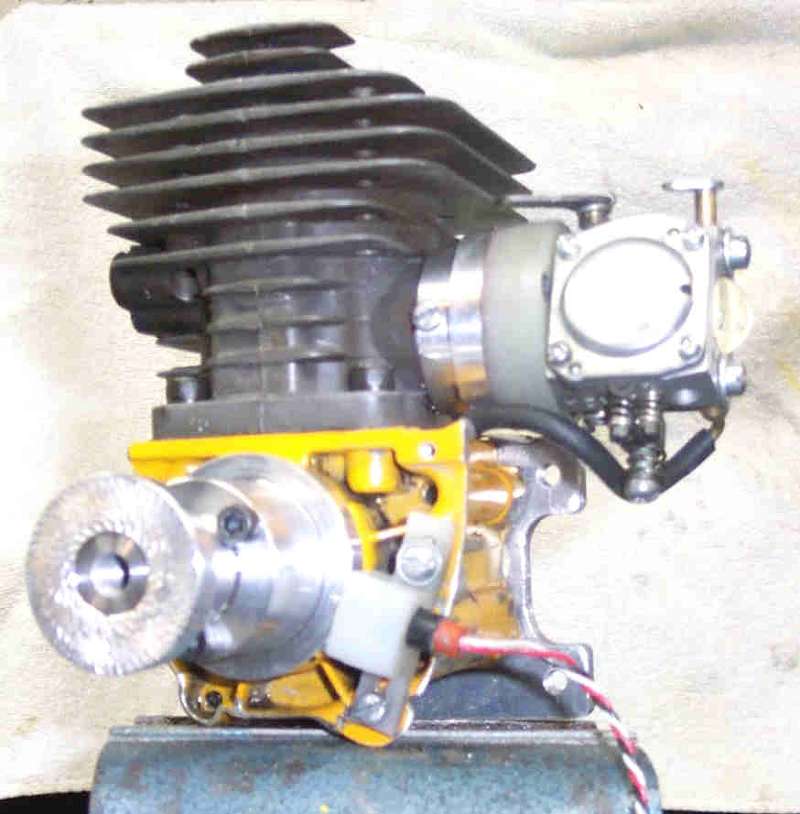

Default Poulan 305 Pro
I ran my Poulan 305 Pro for the first time yesterday and it ran fine, but it seems to develop a lot of play in the crankshaft bearings after it warms up. The play seems to go away again when the engine cools down. These are new main bearings that I got from Poulan. Could it be they are not a quality bearing? Would replacing them with a ball bearing of higher quality be a cure for this problem? The bearings fit tight on the crank and I used bearing mount in the case recess as I thought the fit was a little loose. I have not run across this problem before. Any ideas, guys? Thanks

Old 11-30-2003 | 06:56 PM
Posts: 24
From: Turtle Lake, ND,
Default RE: Poulan 305 Pro
The engine splits verticaly and not like the newer generation of Poulans. The bearing on the mag end was too easy to slip into the case, so I used green loctite to secure it. It was the only cure for the loose fit that I could think of. I do not know if the gasoline will wash the loctite out or not. Even if it did I would not think it would do so in just a few minutes of running as the looseness in the crankshaft showed up as soon as the engine warmed up on the very first run. I am thinking I should tear it down again and see if I can find a problem. If the bearings are still tight in the case, then it would indicate increased play in the bearings when warm. Does anyone know how to pull a seal without damaging it? If I pull the seals I could see if the bearing moves in the case. If the bearing is loose in the case, then what? Is there a cure other than a new case?

Old 11-30-2003 | 09:33 PM
av8tor1977's Avatar
Joined: May 2003
Posts: 7,245
Received 6 Likes on 5 Posts
From: Tucson, AZ
Clean the bearing outside diameter and the crankcase with acetone, and install the bearing with a thin coat of JB WELD glue. Let it set up overnight, and have at it. I've seen JB WELD used to install cylinder sleeves in full size engines, so I'm sure it would hold. The engine will probably last forever and ever in an airplane, so don't worry about future changes of the bearing. Do check the bearing closely to see that it doesn't have any unwarranted internal play, and that it is a nice snug fit on the crank, but from what you describe it is loose in the case. When the engine warms up, the aluminum expands more than the steel bearing, and it gets looser. Also, it is fairly doubtful that you will get the seal out without damaging it. The seal is critical, as if it leaks air, it will lean the engine out. (NOT GOOD!)

Old 11-30-2003 | 09:35 PM
KenLambert's Avatar
My Feedback: (107)
Posts: 886
From: Augusta i i IL
easy fix shim the crank at the rear bearing must be caerful not to shim too much and get it too tight some of the poulans I have done had extra end play it doesn't take much kenneth
