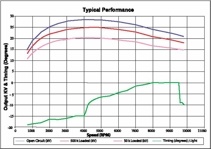

The MB looks pretty good. Looks like it cuts out around 9500?
