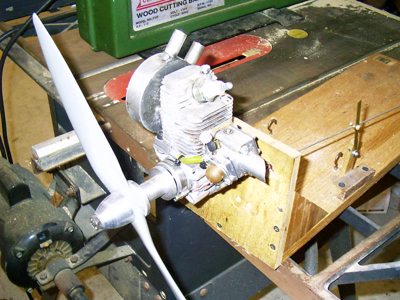

Here is the little mac after plenty of grinding, and some sand blasting. I'm starting to like it more and more, But I don't like the ugly flywheel, that has to be mounted backwards (fins toward the engine) Does anyone know where I can get an electronic ignition system for it ?
I ground the fins off the flywheel, not so much to save weight, but I read that it reduces the drag, (air load) and makes a noticeable diff in RPM, I rebalanced it on a prop balancer. Of course, I'd like to do away with it altogether, and convert to electronic.
Here is the Tanaka I mentioned above, I would appreciate any comments, I'm not liking the SINGLE bearing on the crankshaft, I wonder if the drive shaft from the trimmer helped support the end of the crank, It may be far worse with a prop, than it was in the weed eater. or maybe I am worrying about nothing, Maybe this is normal, and the mac is just over-engineered.

Normally there are 2 bearings in an overhung crank situation eg. as in the Mac 28cc & 32cc trimmers.
The Stihls are always good quality but expensive, don't know about Tanaka.
I do like the look of that crank on the little Mac 21cc!
You sure don't beat around the bush do you!
RCIGN1 - or Ralph Cunningham ( RC ignitions) sells a reliable inexpensive CD ignition system, - I have ordered one, and I will use it in conjunction with a small motorcycle coil.
http://www.rcuniverse.com/forum/m_16...tm.htm#1670614
Look at posts 24, 25, 26. on this thread, these guys are experts, - old and wise.

I ran the Tanaka yesterday. It started easily and idled real well. It turned a master airscrew 18x8 @ 6300 RPM, on 32:1 fuel mix. I think with an APC prop, and 50:1 mix, It might turn 7000. The only "issue" is the play in the crankshaft. At idle, you can see it wobble, it smooths out some at higher RPM, but I don't think this is a very good design. The engine looks real nice, and I had high hopes, You can see I did a lot of grinding on the flywheel, on the front and backside. It's seems fairly light too, 47oz as you see it here. The internal parts look real good too, I don't think it has much time on it, after cleaning it up, everything looks new, and fits well, It's just a poor design in my opinion.

The Tanaka looks good, pity about the bearings ( bearing) though.
What is the shiny part near the front end of the shaft? looks to me like it ran in an outrigger bearing in the trimmer housing.
I wouldn't run it too much like it is till you've found an answer, - the big end wouldn't take too kindly to it.
Not too keen on the ignition coil directly in front of the cylinder, it must block a lot of cooling air.
If that big flywheel was removed and a CD ignition kit fitted, (CD type is the way to go), it would be possible to extend the bearing housing to accomodate another bearing, ( providing you had the equipment and the expertise ).

that shiny end is right were the clutch bearing was, I guess they relied heavily on that, rather than a decent stand alone engine, I guess they never had R/C in mind
I have no way to mount a prop to the Mac, I ordered a prop hub, so I can begin testing it, I hope next week.
Today I am working on a Stihl/ryobi I got a very old stihl trimmer, (FS 40 I think) one with a completely enclosed engine, the entire housing was an off white plastic, with the usual orange trim, recoil in the front, engine inverted, wrap around fuel tank under the bottom. You couldn't seen any part of the engine, it didnt' have the exposed bottom like a ryobi trimmer, and it had a very large 3" diameter knob on the back, that was the choke, strange. I think it was the air filter assembly too, and you rotated it back and forth to turn the chock on or off. It looked very "cheap" compared to the higher end stihl trimmers, I guess even stihl made some "price leaders" Once I got it apart, the engine is identical to a ryobi, with a plastic backplate, reed valve induction, the coil mounted to the cylinder, (no grinding required) I have been researching ryobis, and apparently they come in different varieties too, mine is a single ring, stamped steel con rod, and laminated counterweight on crankshaft. But it has two bearings !! and the crankshaft is rigid ! What I don't understand is why stihl would use that engine? Why would they put their name on something so cheap? Unfortunately it's nothing like the later stihls that have three radial mounts on the rear, and mounting lugs on the side too, like a typical r/c engine.

I tried the carb that was on it, and a zema that we had lying around, they both produced the same peak RPM, although the zema had a crisper transition, I think that might be just cause it was new. I never even took the old carb apart, I know for a fact it was hanging in the back of a tool shed for at least 3 years, I just wanted to see if it would run, and to my surprise, it did
We tried two different coils, and two different spark plugs, both out of the engine, just holding them against the fins, and with all combinations, the spark was very weak when hand propping, I didn't think it would even start by hand, but a few times it did.

I have an engine that appears to be identical to the one originally posted. It is a 21cc and originally came with roller bearings on the front and rear. The case castings appear to have been made with the option for ball bearings, so I bored out the front and anstalled a standard ball bearing ( 10mm X 32mm X 7mm) I left the rear roller bearing in as I didn' see the need to change it with the ball bearing on the front of the case to take the thrust. I also cut 60 thousands from the base of the cylinder and changed the exhaust and intake ports consistent with the info given in " Don't forget Echo". I used a ball end mill to raise the ports 40 thousands to compensate for the material removal from the base of the cylinder. The piston top was reshaped to give 15 thousands clearance between the piston and cylinder head. A CH syncro spark was used and the timing set at 30 deg BTDC. It also has a new Frank Bowman ring.
Performance isn't quite what I expected, but it does turn a 15 X 6 APC at 8500 rpm. I haven't played with any other props at this time, but It has only 15 to 20 minutes of run time on the new ring.

I's good to know that you have actually done all these things (which I was only thinking about), now I know that a ball bearing can actually be fitted.
Did you fit a bigger carb? do you think that the small carb be keeping the power down?
