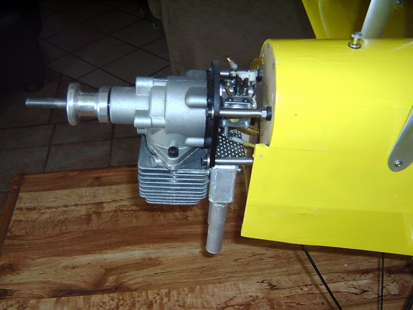

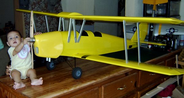

Well, it's been a little at a time project so it's taken a while, but my Nitro Planes Big Tiger Moth is getting close. About all I have left is to rig the flying wires, test run the engine and then screw on the cowl, and add the decals.
I took out the squish band in the head, left out the base gasket for more compression, and raised the exhaust port to get 150 degrees of timing on the Ryobi. It also got a Frank Bowman ring, an 11mm carb, and a Whacker muffler. It will be run on Gas/Glow.
The plane is a very nice size at 78" wingspan, and seems made for the Ryobi. We'll see how it flies, hopefully soon. It wasn't a bad build, though I had to have the company e-mail me instructions. Wing alignment is a bit of a challenge, but all in all I'm happy with the plane so far.
Oh yeah, I've got to finish rigging the inter-aileron connections too. I changed the design from two ailerons to four, so that took a bit of extra time also.
Here's some pics...

Hey Capn' John,
You had asked about pics of this setup. Did you notice I posted these? Sorry it took me a while. Finished the aileron interconnects and the flying wires today. Maybe tomorrow I'll add the decals, check the control throws and c.g., and test run it. We'll see....

Well darn... took my big Tiger Moth with the Ryobi to the flying field today, and decided it was just too windy for a test flight. (About 15 gusting to 25 or so.) Oh well.
The airplane needed 5 ounces of weight on the engine to balance where recommended. I probably could have moved the battery and fuel tank forward and not had to add the weight, but I got lazy. 5 ounces isn't much with this much wing area. I'm running Gas/Glow, so anyone wanting to do this plane with a Ryobi on electronic ignition would probably find the c.g. falling exactly right with no added weight anywhere.
On the ground test run, my throttle servo failed in the full open position! Sure glad that decided to happen on the ground and with the plane tied down! Wouldn't be too much fun flying around at full throttle for 20 or 30 minutes until it ran out of gas!!
I'll let you know when I do get to test fly it.
