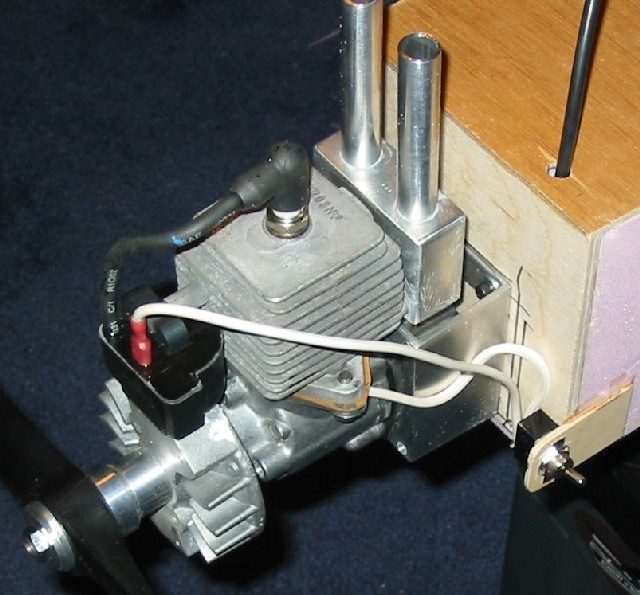

In the Ryobi's defense though, I haven't had a problem with the throttle linkage on the rear carb...straight shot to the throttle arm with a ball link...or nylon nosewheel steering arm..
http://www.crazyherb.com/BigPink/Picture015.jpg
Whereas, with the Poulan 42cc, I had to buy a special "rotator" manifold to get a straight shot linkage to the throttle arm....not a problem...just another bolt-on part..
