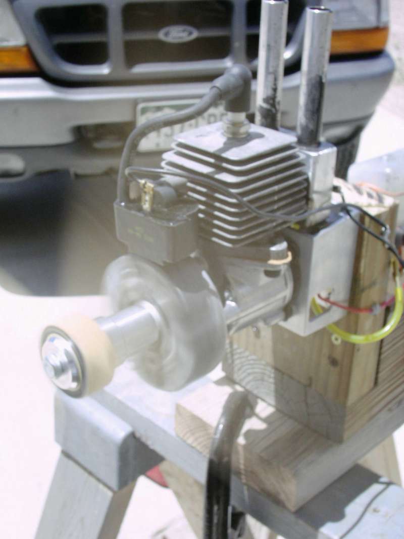

Old 06-14-2004 | 12:45 AM
Marlowe's Avatar
Posts: 40
From: Penrose, CO
Default RE: MAX RPM TO RUN ENGINE
I just got my Ryobi 31cc converted and today I put about 30 to 45 minutes break-in on it. It was swinging a 18-10 Zinger prop at 6,300 RPM on a 32:1 gas-oil mix. It was running on the rich side and throttle down to a steady 3300 RPM. I monitored the head temp and didn't allow it to exceed 300 deg F. After 10-15 minute runs I let it cool down to the ambient outside air temp, about 75 deg. I'm a bit concerned that the exhaust oil residue is very black. I hope it isn't from engine metal. Anyone have any ideas?
After today's test runs, the engine was noticeably easier starting and better running. It has been recommended that the Ryobi have a break-in of 4 hours of which 2-3 hours can be inflight time!
