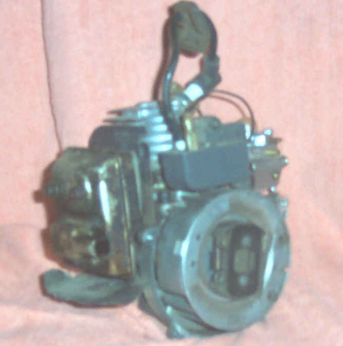

Joined: Mar 2003
Posts: 296
From: N.E. OREGON
Dean,
I stopped by my favorite saw shop and was given a SRM-2400 trimmer head. If I need another, I'll e-mail you.
4.5# as pictured.
Doug
4.5# as pictured.
Doug
