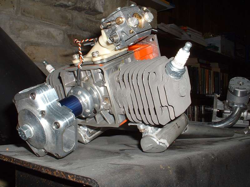

Here's mine. I have a friend who scoured the pacific northwest looking for old echo chainsaws. He found 3 and I got the crank from one of them. We ordered crankcases, pistons, cylinders and prop adaptors from BME (he gave us a very decent price) and we each built an engine. The crankcase which I believe is from either the backpack leaf blower or air compressor is much more suited for RC use than the chainsaw case. The chainsaw case is difficult to adapt a mount to and this case shown has 10-32 fasteners on each corner. I attached an aluminum plate to spread the load out. Haven't run mine yet. Will get to it this summer. Haven't built an airframe for it yet.

Thanks loads for sending the pics out. It looks like you have it going on. I would love to wind up with one of those. Thanks for the tip on the backpack case being more suited. It looks like you bought the Sec. right jug so as to throw both plugs the same way. Thats the only way to go. I'v done alot of singles but no twin. I just checked into a anodizing set-up for the engines I do yesterday. If you get one too many stock backpack engines---let me know I will take one if you want to sell it!!!! Thanks again for the Pics and let us know how it's running!! Hooker53

I made a square hollow mount and put the ignition and coils inside it...Never did find the pictures....The mount is easy, just drill the case screws all the way through and run 10-32 bolts all the way through the case from the front into the mount plate....[8D]
The cylinders can be turned 180 degrees but it takes some bolt hole mods and there are locater pins in the way...Still looks a little funny, the plug angles are different but at least are on the same side..The carb can be mounted vertically on a new block made from G10 epoxy board, then there's no funny linkage to the throttle servo....
All the threads on the engine are metric, you might want to replace the 10-32 mount screws in the corners with 5mm x .8 screws, the diameter is a little larger and will hold better..10-32 screws will strip out you go too tight....

In post #8, pict 2, isn't the carb butterfly backwards?

Hey Antuque. Yea--I saw that but look more like a choke plate to me. Carb butterfly don't have any holes in it does it??? Later Roy

Sorry about that ! It didn't register with me that it was the choke plate I was looking at and not the throttle plate. Old eyes is my only excuse !

Here's pix of the carb linkage. It ain't pretty, but it works well. Never bothered to do anything about the choke - just intended to leave it open when flying and close it off when not for protection. Carb sure sticks out a lot. Again, not pretty but functional. Sure won't be difficult to choke! RCign, interesting point about the metric threads. The 10-32 fit excellent, not sloppy at all. Must have another look at that. Where would you recommend buying a set of quality 5mm x .8 fasteners like you're talking about? Last thing I want is the cylinder bolts backing off! Regarding the cylinders, this is what Mr Baker sent out and they fit perfect. Didn't have to mess with altering anything - it all lined up perfect. Bought the mufflers off a gent here on RCU - I think they were D & B. The other thing I'd like to replace is the prop hub bolt. The bolt I have is from Home Depot. I seriously wonder if hardware grade is up to the task. I've been told about an industrial fastener supply firm here in the city - will check them out. As an aircraft mechanic I'm spoiled by aviation grade stuff - that's what all those are on there now... but if they're not the right size I'll swap 'em out.

Keith sent you 2 of the same side cylinders, like he uses on the D&B twin..
Most hardware stores sell metric fasteners...If the prop bolt is not grade 8 it would be a good idea to find one... I buy all grade 8 fasteners from a large industrial supply, MSC...Cheap when you get 100 at a time.
The 10-32s are only about .006 smaller, and the threads are almost exactly the same..I tap my G10 carb blocks with a 10-32 tap and use 5mm bolts, they "squeak" in and are almost self locking....
