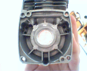

I have a old weed eater here that was given to me. I am not sure if it is a good engine for conversion or not. Can anyone give me any details on it? It is a John Deere 240, the model# on it is MO240GA. It has a 1.269 bore and a 1.06 stroke. It has ball bearing on both ends of the crank, and I think, needles on both ends of the rod. It has a ZAMA K982B carb. What do you think convert or Junk?????????????

Here is some pictures of the John Deere

looks like a Kiortz (Echo). possibly a 24 cc?[&:]

It sure does look like an Echo. Should be a good conversion engine. The Echo/Kioritz are the better quality engines, and are generally light, powerful, and well built. I would convert it myself. It would work fine in an airplane with around 1000 square inches of wing area, weighing from 9 to 11 lbs., or perhaps a touch heavier if it is a floater type plane like a Cub or something instead of an aerobat. You can use it with the original magneto, or convert to electronic ignition for less weight and easier starting.
Hey, you already own it right? A couple of hours work cutting the excess metal off, gut the muffler, buy or make a prop hub, throw on a 15 x 8 APC prop, and see how it does! If you like it, then try a bigger carb as well.

I read through a lot of old post today and I too think it looks like an Echo. I cleaned it up a little more today and found it has real rough bearings but I am going to test it anyway. If it seems to have potential I will get new bearings, cut off alot of weight, set it up for a C@H. and look for a better carb. According to my calculation it is a 21.6 CC. Does that sound correct? Would it be refered to as a 22? I am enjoying this I haven't played with a conversion in several years. My last one was a 30 cc Homelite that is flying a way over weight Ultrastick. Well sort-of anyway.

most definetly an echo 21.2cc... bore is 32.2mm, stroke is 26mm pretty close to what you measured. this is the same engine that FPE converts and sells as their 1.3 for around $400. echo says it should run about 10,000rpm WOT so it likes to spin. with stock 8.5mm carb and gutted muffler it should do around 8,000 with a 16x6 or 15x8. haven't tried it yet but a smaller prop might even be better.

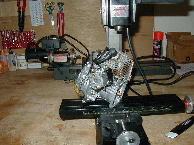

bearings for 21cc Echo are NTN 6201 and the seals ISCD 12 22 45 Got one sitting on the desk with 2 piston rings. Explored the muffler, lost the screen and opened up the restriction baffle under the 3 screw. This muffler has more open area (1/4 holes) in the upper baffle(/ bolt compression inset) than the area of the head exhaust port. But the 'diverter weighs 1/2 as much
First one was trashed internally so it became a 'what if cut-up'
John Deere 240 ....Hummm Add to lookout list!

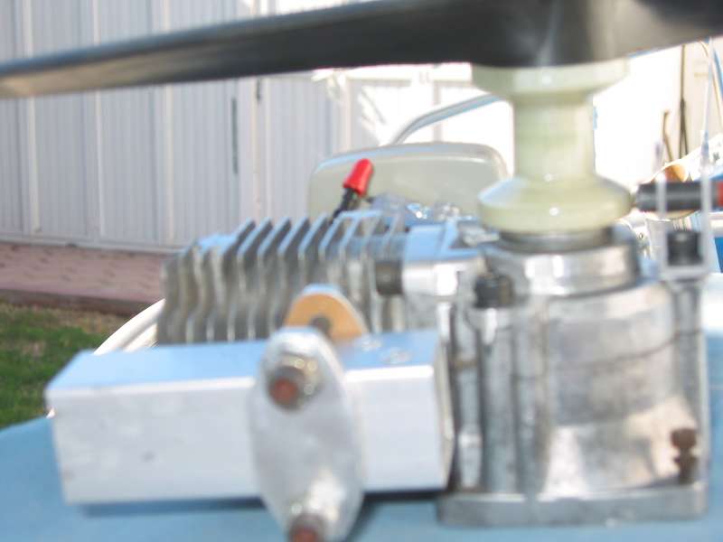

if you want to buy OEM gaskets then find an echo dealer and get parts for model "SRM-2100"
and as long as you're doing a rebuild you can cut the rear crank stub off right at the bearing and plug the oil seal hole in the case. this will save some weight and reduce friction. the bottom of those aluminium asthma inhaler cartridges are a perfect 22mm. just cut a 1/4" off, smear it with locktite and drive it into place with a large socket. some of the big electrolytic caps also have a case of the right size.

Hey all you guys, thanks for all the help, It is really appreciated. I will get my bearings and seal this week and see what happens next. Dave, the inhaler bottom that I had around here is 25.7mm and is plastic. Oh well, I am going to make a plug.
