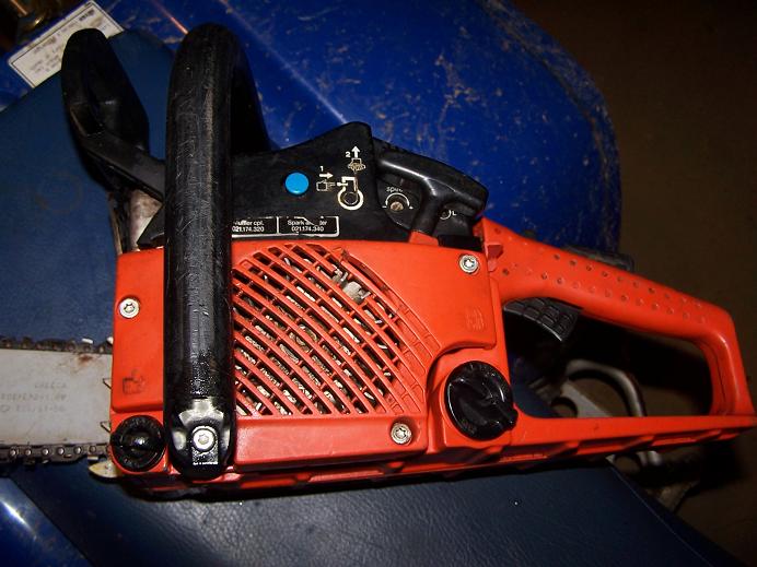

From what I understand this is the same basic engine as the Brison 2.4. Is there anyone out there that offers a conversion for this saw engine? I have an old Dolmar (Makita) PS 401 that gets very little use as a chainsaw. I am willing to sacrifice this as an aircraft engine in lieu of my Husq 335xpt, Stihl 034, and Husq 272 xp.
What is involved in converting this engine? I have never done a conversion, but am very good at taking things apart! :-)

Take it apart, take the crank out, Push the bearings out or cover them with some duct tape...cut or grind off all the extra casting until you just have the round part of the case...Make a flat plate that uses the case bolts to hold it together..You can drill out the case bolts with a .194 drill and use 10-32 bolts all the way through the new back plate to hold it together..cut off the rear straight part of the crank a little above flush with the rear crank seal...Re install the crank..Make a new prop hub with a magnet in it and a bracket for a Hall sensor for the CD ignition....Picture is a 4.2 Sachs chainsaw conversion, same idea except the ignition is inside the mount...

Default RE: Convert a Dolmar/Sachs 40cc chainsaw engine
Ralph, you are a beast! ... and I mean that in the nicest way! You directions sound reasonable, though I am sure this will make a lot more sense as I start getting the thing torn down.
Looks like I am going to need to acquire or make some parts to make this thing work. Will I need to buy an ignition system for it? Where? From whom? How much?
How would this compare to a G-38 or G-45 in performance? Weight?
Needless to say, those pics you posted of your conversions look awesome!

Hgiles....Stronger and lighter than a G38...C&H can set you up with an igntion...[8D]

I have a Sachs model 102 that is also a 40cc saw. I was disappointed when I took it apart to find it has roller bearings. The cylinder is almost identical to the one on my Brison 2.4. The bearing on the bottom end of the rod is uncaged rollers. I have thought about putting a ball bearing in the mount at the rear to deal with the side thrust. Would this be a workable solution, or is there a better way to deal with this?

You may be able to install a thrust washer? Ask RCIGN....If anyone knows ...its him. He is the man!!! Capt,n

My Dolmar ps401
is the rod 2-piece with bolts holding it together or one piece?
a ball bearing to take thrust load would be better at the front...BUT all the old quadras and curent US engines 35-42cc engines get by just fine with rollers on both end of the crank and (at least on the quadra) a brass/bronze thrust washer.
