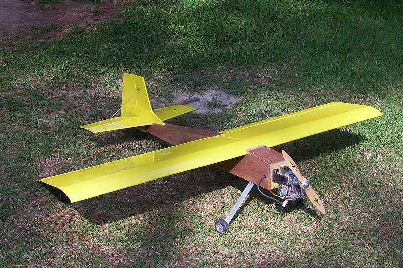

I have the Poulan 46 on a Ryan's Rebel. It's cheap, fun, and easy to build. Oh, did I mention its a great flier?

Default RE: Plane For A Homelite 45cc
Great looking model! Wait a minute, I have one like that! Really, looks good. I bet it is a blast to fly with a 46cc. Mine hade the Ryobi then lI ater moved to the G-38.
Ryan
