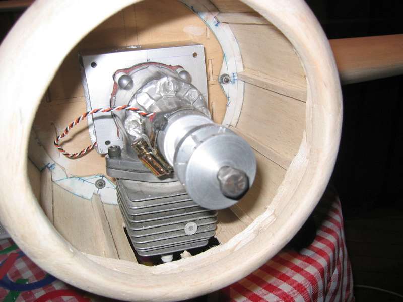

Hello Tato
Haw are yours flights???? Tato, do you have some canopy for my Extra 300, if you have one please tell me, and I want some land gear too.
Sorry but I put some picture of your plane with your Ryobi, churly somebody ask something to you.
By
Some pictures of Tato
ID:	163696   Click image for larger version
