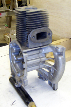

Here's a Robin, about 25cc...Haven't run it yet...2 lbs, 4 oz..Easy conversion, cut off the extra casting, a G23 hub fits the crank..The rear case has three holes to mount to the firewall..This hub is a custom for my ignition..The sensor is in the ring behind the hub, on the front of the case..

This particular engine is the Robin NB-26.I was discussing this with Harold a while back and he mentioned that he was sending his engine out to you to be converted.I have two of these myself that I bought years ago with the intention of using the stock ignition system.Like some of the Poulan engines,I found out that the coil is not mounted to the engine but rather to the cover instead.Many of these were converted over to stock ignition anyways with the addition of a coil bracket that was designed by a local machinist who was at that time involved in the hobby.They worked extremely well and seemed to be very low in vibration at all speeds.
I haven't finished my two as the gentlemen who was making the parts for these engines has since left the hobby unfortunately.The engine seems to be very similiar to the Zenoah G-23 in crankshaft design and was very interested to read that a G-23 hub fits the Robin 26 also.Same taper and everything.I have all of the machining of the engine cases completed so all I'm really missing to get them going is prop hubs and some type of ignition system.I was wondering if you could expand on the equipment side of things and tell me what is involved in converting the Robin 26 to electronic ignition?Would like to get an estimate of cost of parts if possible also.Any input,most gladly appreciated.
P.S-Was wondering why the cylinder is rotated 180 degrees from its stock configuration.Both of mine have the spark plug facing forward.Was this done intentionally?Just curious.

Looks like a great little gasser...Didn't want the spark plug so close to the prop....All the internals are symmetrical so you just turn the crank and cylinder around in the case...The front of the case casting is round, with some 45 degree angle pieces..I milled these off and made a ring to press fit around the casting and will put the sensor in that ring...The G26 hub has the same taper and could have a matching ring pressed onto it for the small magnet to trigger the sensor...He sent a C&H syncro spark along with the engine...The carb needs to be rotated 90 degrees so the throttle servo can be connected without a bell crank...A 3.8 thick G10 block will do that, and make the carb closer to the cylinder...He sent a WA197 carb, which should be perfect...There's a new Walbro, same size, that has a choke plate..I'm getting some of these for other small gasser conversions in the future..The G23 has 2 bearings on the front of the crank, with the outer one being the seal for the case..The Robin has only 1, and the case can't be bored enough for another...I should have some rpm numbers today with 18-6, 18-8, 17-8, and 16-8 props...
