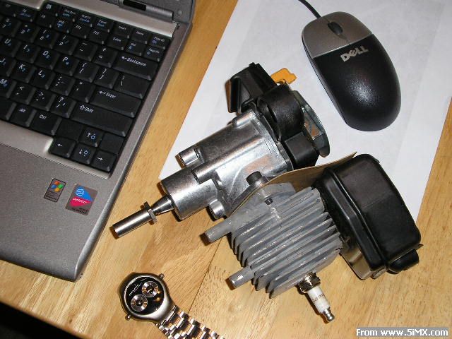

This is my Ryobi 31cc new engine, bought from harbor freight store, $49.99, throw away lots of parts of the trimmer, and the core looks pretty good even now the rear cover need be trimed and muffler still heaviness. Imagine the sound and power in the air........
I can't wait.
