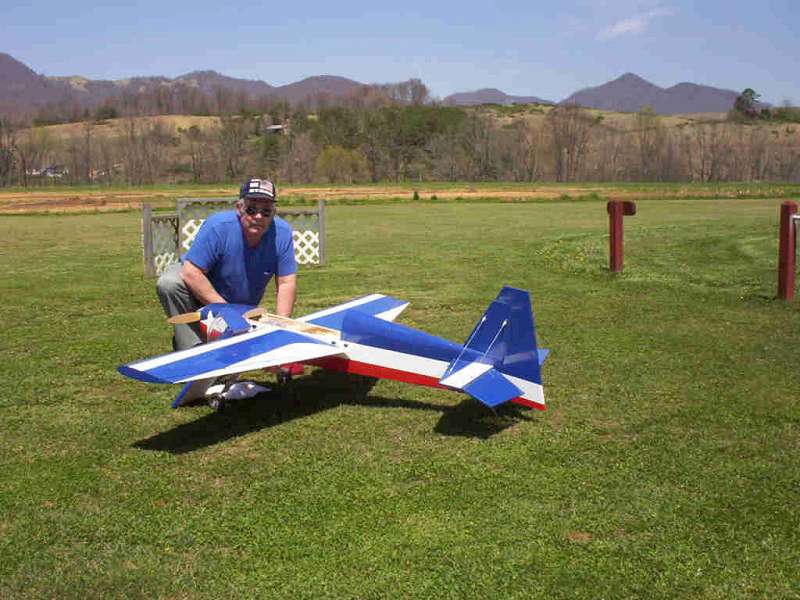

Old 12-24-2004 | 11:43 AM
rsrogers's Avatar
My Feedback: (10)
Posts: 563
From: Clyde, NC
Default RE: Conversion for Texas Hurricane
I dont know if you can tell that well but here is a pic of my friends Hurricane with the TNT gear. He's using a BME 50 swinging a 22" prop with plenty of clearence & no where near flimsy like the stock.

Old 12-24-2004 | 11:59 PM
Joined: Mar 2003
Posts: 30
From: Tyler, TX
Thanks for the addition info. I am also considering using the canopy for the extra as was suggested. I have dismantle the saw. There is some carbon build up on the cylinder walls and piston. I am going to take the head to the local saw shop and see if they can hone. I am going to replace the piston and ring while I have it apart.
Are most using a custom mount for the motor or is there a dealer one that works well?

Old 12-26-2004 | 04:55 PM
rsrogers's Avatar
My Feedback: (10)
Posts: 563
From: Clyde, NC
I have more pics but where I dont have a clue. I got a new computer & all the pics I had on my old one were stored on CD's. If I can hunt some up I'll post them.
On mine I used Hitec 625 MG servos on Ailerions & Elevators, a 645 MG on the rudder and of coarse a standard on the throttle. I placed everything where the Manufacture recomended & had no balance problems what so ever. My friends is slightly more tail heavy than mine was, only difference being his engine is slightly lighter, and his lands with a slight nose high attitude with a little more throttle on it where as mine settled into a nice level to nose slightly down sink rate. With either plane though landings were "trainer" like. Very stable & predictable.
If you have never flown one of the hurricanes but have flown an aerobatic plane you would never guess they belong to the same family. There an excellent aircraft & I would recomend them to anyone (with a little experience) wanting to move up to a larger plane. Also very well built w/ excellent hardware
