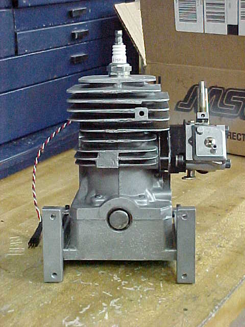

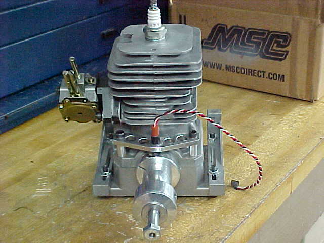

ok guys i got another one for ya. (sorry not related to welding) the guy converting my engine shot me an e-mail and said the engine is all re-assembled and running. BUT there is what he called a severe vibration while running. it ran smooth in the chainsaw and we are thinking it has something to do with the removal of the flywheel. it has EI on it now so there is a nice looking hub where that used to be. anybody know what to do or ran into this problem? i need to ratify this problem so i can get the engine one the plane and order my muffler from Mr.Lambert.

I noticed my homelite run's with bad vibration when the prop is mounted so that it is inline with the cylinder at the top of the stroke and it has very little vibration when the prop is mounted perpendicular. also EI

Might want to check the original flywheel for any intention imbalance. Engine might have some its balance weight in the flywheel.

Old 01-01-2005 | 03:58 PM
  #39
rcrobby82's Avatar
My Feedback: (14)
Joined: Sep 2004
Posts: 60
From: ruffs dale, PA
Default RE: McCulloch 60cc conversion
ok, the vibration is still there, timing is good all the internals are good. does anyone know if mccullochs are externally balanced or how to balance this engine out. here are some pics of the conversion. any help would be greatly appreciated. mr. lambert, on your mculloch did you have any balance issues?

mine ran preety smooth . the crank is balanced internal . but keep in mind this engine has a long stroke you running a larger prop at lower rpm's is the best performance i got out of mine .
