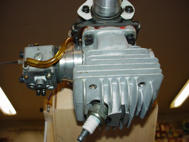

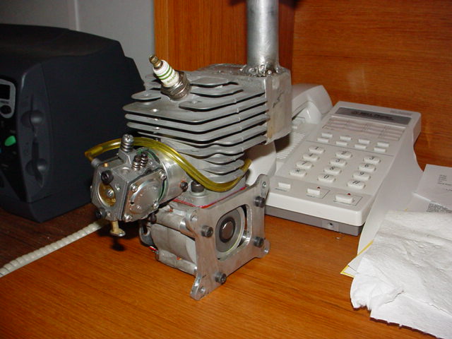

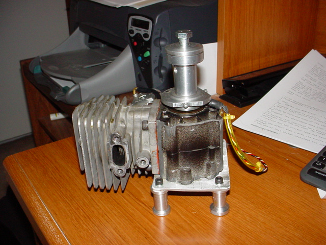

try a poulan 60cc you can get them in under 4# ready to fly I have been flying one on a 80" cap for a couple years .

You also may want to consider the poulan 54cc I have done several of these and they produce lots of power and still under 4# this pic is of one of the first 54cc's I did have done lots of changes to them now including lighter better looking senser setup and muffler but don't have a newer pics at this time .Some freinds are flying them on the world models 300 planes .

went out and took some pics of a different 54cc that belongs to a friend , it is for sale with ign.

Loooks nice. Is there a commercial muffler for it or does a person have to go with custom built?

i build the mufflers also and yes it comes with one you can see more on my website

To KenLambert : Neat job on the Poulon 54cc. Did you make a custom intake flange to mount carburetor ?

Default RE: What's a good 60cc +/- conversion canidate??
yes i machine an adapter from aluminum and use a thin plastic insulator .
