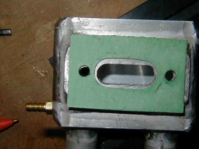

What do I neeed to do to a Ryobi wacker muffler to make smoke?

I just tapped it with a 1/8 nipple just behind the exhaust port and threadded the exhaust stacks another 1/2 inch to give the oil somewhere to puddle and burn (probably not needed but it works).

This is how Abell mufflers does it. This muffler is for a Homie 25. It is just a barbed fitting screwed into the side of the can. There is nothing on the inside.

Man, if that gasket actually fits the engine exhaust port, the muffler lip overhang at the port is a god aweful restriction to flow!!

Yup! That gasket fits the motor just fine. I did a lot of dremel work on the muffler.
