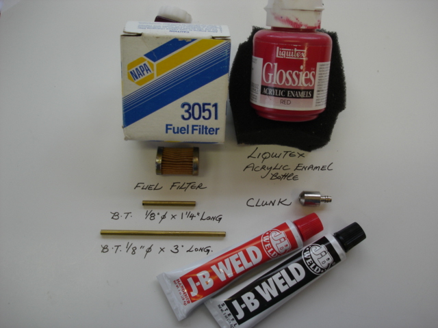

Hi ALL,
I have set up a SuperTiger G.90 converted to gas using CH Ignition System and set up for crankcase pressure with Iron Bay Fuel Regulator with their one way valve, one tee for fuel overflow and using a Great Planes Gas Valve for filling tank.
Also have a fuel filter attached just behind the fuel regulator.
Engine is tuned in with High & low needle valves reasonably set....good idle , transition & high end all working fine.
The problem I am having is that after engines starts running, the fuel lines soon develop a lot of air bubbles which does not necessarily stop the engine from running but as soon as you move the plane from the horizontal position on the stand, and tilt the plane nose up it quickly dies.
Yesterday I took the wing off and removed the fuel tank & regulator, just letting them dangle away from the fuselage to see if excessive vibration from the fuse was the culprit. Still getting the same bubbles occuring....I even changed back to muffler pressure but same result.
All my fuel lines are new, fully engaged and secured with small fast ties. No fuel leaks in fuel lines or fitting observed and when overflow dot is removed, I get a wwhhossing sound which tells me I am getting good pressure.
What could be my problem??? I am totally baffled why the bubbles are occuring in a pressurized system like this?????
Any advice or suggestions at this stage would be most welocome.

I managed to obtain the necessary parts at my local NAPA Auto Parts Store.
These parts are to build a separate header tank which also doubles as a superior fuel filter &
bubbleless engine supply to help solve my mystery bubbles in a pressurized gas setup using
an Iron Bay Fuel Regulator and crankcase pressure supply from my Supertiger G.90.
I didn't have a 2 oz fuel tank available so opted to use a 2 oz Liquitex Acrylic Enamel Plastic Bottle.
Photo #1 below shows the simple items used including K&B 1/8" Brass tubing, long set J B Weld, small
Napa 3051 Pleated Paper Fuel Filter and chromed brass clunk from a damaged 6 oz sullivan fuel tank.
I also used a soldering iron not shown.
Fuel Filter came with a little rubber/plastic check valve inserted in one end.
Its not needed, so I simply pulled it out and discarded it.

JB Weld was first applied around the tubes on the inside of the cover, then on the outside as shown.
Doing this ensures that the pipes are held secure from pressure applied when attaching or removing the
tygon flexible fuel lines.
The header tank will be installed upright in fuselage with inlet/outlet tubes exiting out of the bottom.
The inlet shall be connected to the adjacent main fuel tank.
The outlet from the centrally located pleated paper fuel filter shall be connected to Great Planes Gas
Valve Fueler, then on to the Iron Bay Fuel Regulator, then on to the nearby carb.
Hopefully after the JB Weld fully sets up, I can then plumb the fuel tanks all up in the fuselage above
wing C.G. position.
After installation, I will post my initial results, hopefully I will now have a pressurized system without
the mystery bubbles and the header tank will serve an additional purpose as it has a super fuel filter of
15 ~25 microns........far better than the regular fuel filters used to remove trash.
